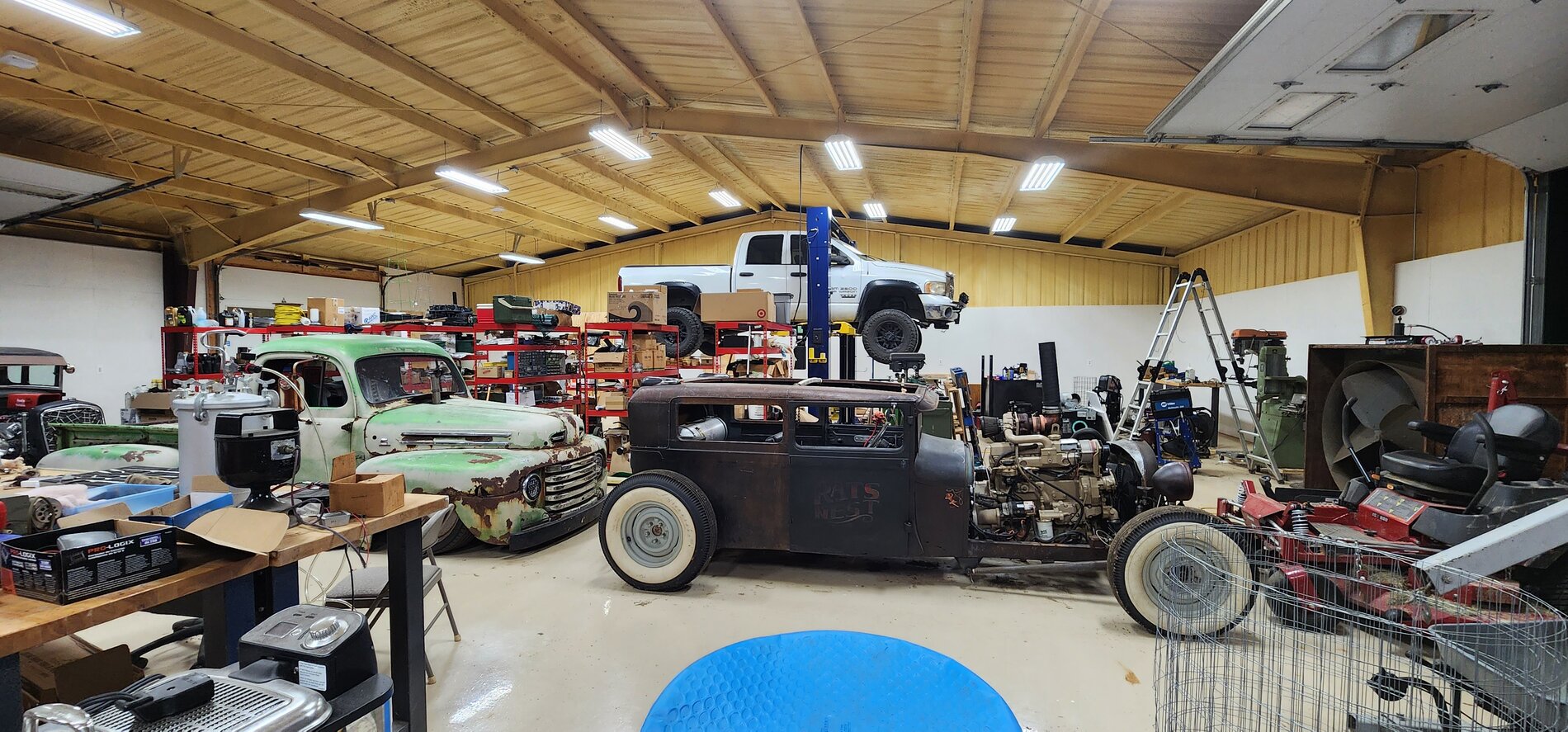

YoHoot , Nice shop and hot rods ! That is my kind of shop .....:D:cool:;)
Couple '30-31s and a 49 f1 ?.... and a '0' turn lawn mower?
