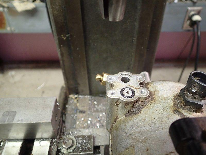

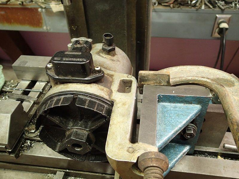

I finally got a warm enough day to work in the shop. Pulled the fuel canister and got it set up in the mill.....that took a little doing, and what I ended up with wasn't real strong. Good thing I didn't have any heavy milling to do.

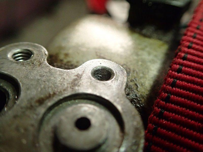

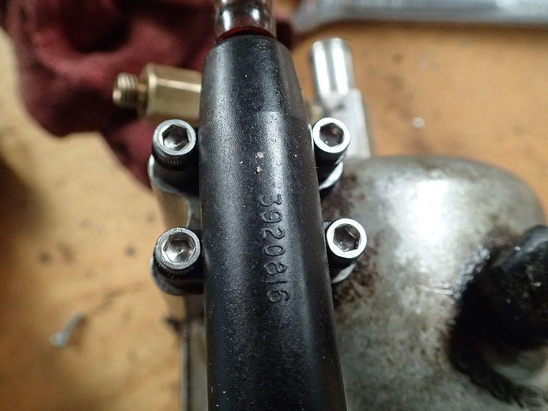

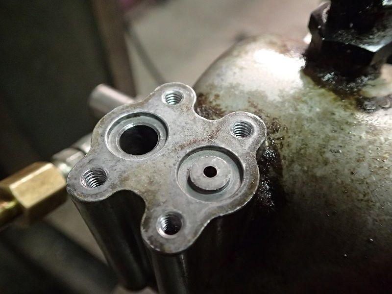

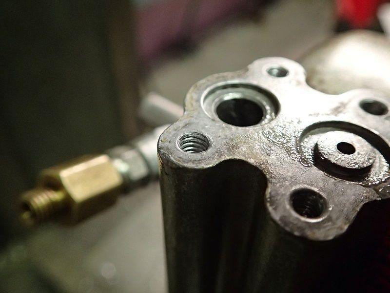

Once that was done, I used a #29 drill to drill out the old threads. I tapped the new threads without moving the table, so the threads were dead square with the hole. I needed two taps....one standard tap, and one I ground the tapered end off of so it would cut threads all the way to the bottom of each hole. On two of the holes, you can only drill 5/16" deep, or you'd drill into the housing, and have a leak. So, you only have about 8 or 10 usable threads in the holes. Here's a few pics of the new/old threads, and the finished valve attached to the canister.
The hole on the left has the new #8-32 threads.
This is a good pic showing the new threads compared to the old.
This shows all 4 holes with the new #8-32 threads.
I had to open up the mounting holes in the valve, too. The nearest size was a #19 drill .166".It seemed to leave enough "meat" around the screws to hold well. The valve now is snug and tight. I test drove, and no obvious leaks. The real test is to see if it fires right up tomorrow, or if I still have an air
