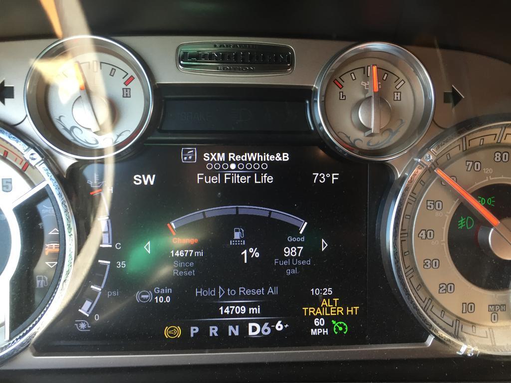

Interesting that my dash info screen will be calling for a fuel filter change at 10,000 ish. I have 6000 miles on this filter set amd only 38% life remaining (all according to info screen). But i might stretch it to 11,000 or 12,000 because the manual says every 15,000. Info center isn't the final say. Manual is the final say

No advantage I know of to an early filter change. If the EVIC is calling for an early change it may be because of fuel usage. If you tow a lot you use more fuel. If the computer keeps track of approximate fuel used ( and I'm not sure it does) it would make sense to need a filter change based on gallons consumed rather than mileage alone.
I have been told engine hours has been added into the formula.There is always small print in the owners manual..........info subject to change

My EVIC only shows one idle hour (although that's not accurate). And I only towed 300 miles on this set of filters

Even though I'm out of warranty (148k miles) I still stick by the 15k interval (or less) for both filters using MOPAR, Fleetguard, or Parker/RACOR. My lifetime average miles per gallon per fuelly is 13.6 mpg. 15,000 mile interval/13.6 average miles per gallon = 1,103 gallons of diesel filtered (a little over (20) 55 gallon drums of fuel filtered). I've dissected my rear separator quite a few times, and I'm confident they're doing their job as designed. I do not see any loss in performance at these intervals. RAM / Cummins really stepped up in fuel filtration on the 2013 & newer CTD HD pickups.
