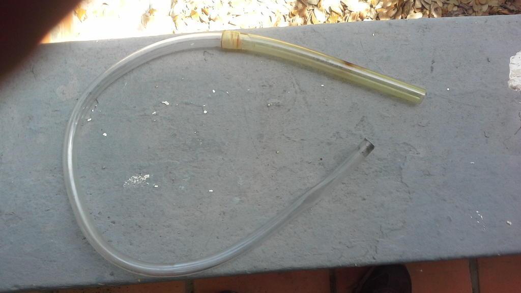

There is no factory hose on the rear. And if I remember correctly, the rear drain nozzle is a bit smaller. So i bought some (IIRC) 3/16 ID-5/16 OD vinyl clear tubing and jammed it inside the stretched out end of the factory tube. (The end that was mounted on the drain cock). See picture. The small end fits the rear drain cock, the large end fits the front drain cock. Works flawlessly and not too messy unless i get careless.

The clear hose the fits offer the rear filter barb will slide inside the existing engine mounted hose that hangs off the drain valve. SNOKING
