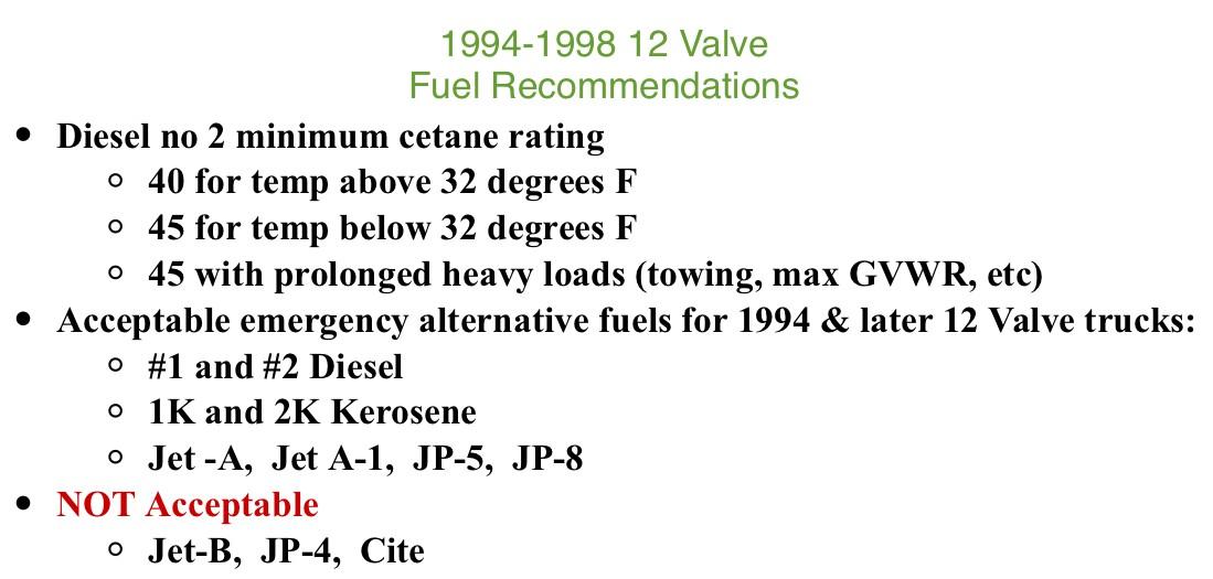

Hi folks,
Forgive me if this question has come up before but I need ask.
I have read that the Cummins 12 valve can run kerosene or home heating oils in a pinch without any major issues. Obviously, the normal Diesel #2 low sulfur fuel is best, but my question is this;
Can I run the Cummins on home heating oil if I mix it with #2 diesel without injection pump or injector issues/damage?
I ask because a friend has offered me several hundred gallons of home heating fuel.
I also have a Cummins generator (diesel) so this is valuable to me if I can run it without problems. I have read that home heating oil is almost identical to #2 diesel.
Anyone have any good experience regarding fuels?
