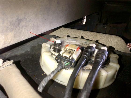

I had the same problem a few months ago, when I was fueling I noticed a puddle of fuel under the truck. I was not trying to squeeze more than the tank would hold just filling up. I got home and put a little pressure into the fill neck and that is how I found the leaking fitting, on closer inspection the rubber plug on one of the fittings had dry rotted. Found a rubber plug in my toolbox and problem fixed.

If you have to remove the tank, do the vent modification while you're at it and get another 3-4 gallons on board when you fill up.

After checking for the rotted plug, I would tighten the white "jar lid" a bit - it's not uncommon for them to be loose.
No, It is a tight fit but if you take your time you can do it. Took me about 15 minutes to work the new plug and clamp onto the fitting. A small flashligt will help you see the fitting

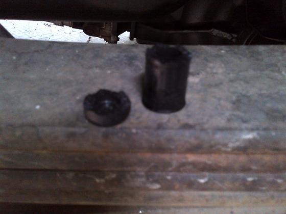

SWithrow, That was the problem,had a crack in the top of the plug, I had to make my own as noone here had any not even the dealer, thanks alot for the help.
