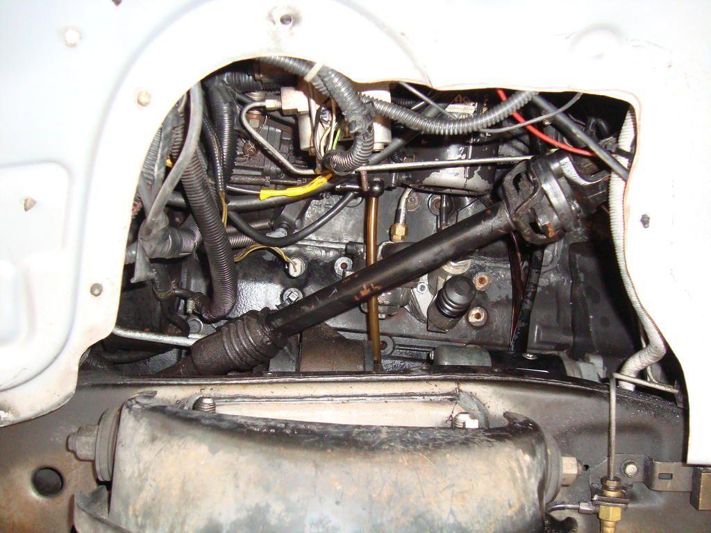

Remove left front tire. Remove plastic inner fender. Metal cutting saw of your choice. Pay attention where the blade is at.
Impressive, GAmes!
@Bluebird, I guess it depends how much room you like to have. Some folks are ok with working in tight spaces. I prefer to clear everything out of the way. On my '95, I actually removed the master cylinder and brake booster and worked from the top. I have a mityvac for brake bleeding and my lines were all new so that I didn't have to worry about breaking lines or frozen bleeder screws. There is an important little clip from the brake pedal to the booster push rod that has to be replaced if you go this route -- it was about a dollar at the dealer, it has various part numbers: 04581512AA, 04294036, 04019421, 06035334.
