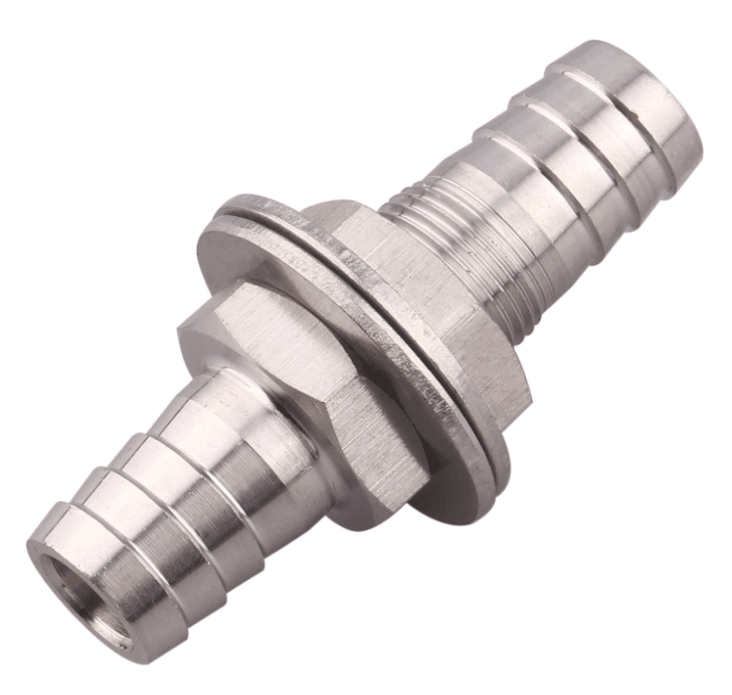

Makes more sense the flow would be irregular, is there such a think as a double barbed fitting with threads at the base on one side? I was thinking if I could use the barbed potion to attach a hose or tube to sit inside the tank on the bottom and then thread it in and attach the 1/2" return hose to the exterior barb fitting.
You mean something like this?
Amazon ASIN: B08DXJXBYL
It's called a bulk head fitting.
But you are really overthinking that issue, the fuel sloshing around in the tank while driving gives way more air into the fuel then your return from the FASS.
The point is to keep more fuel on the bottom, Sure it wont stop the issue I'm having completely but it will help alleviate some of it no?
What would you recommend? Keep in mind I'm not re-plumbing an OEM system or fuel basket. I rather like the idea of the bulk head fitting, that or a Y barb threaded into the 1/2" port at the sump on the bottom; I think keeping the return closer to the feed and the tank would be better for flow than having it father away inline somewhere else.
