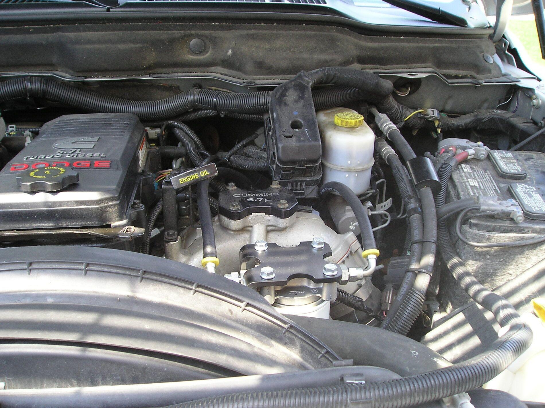

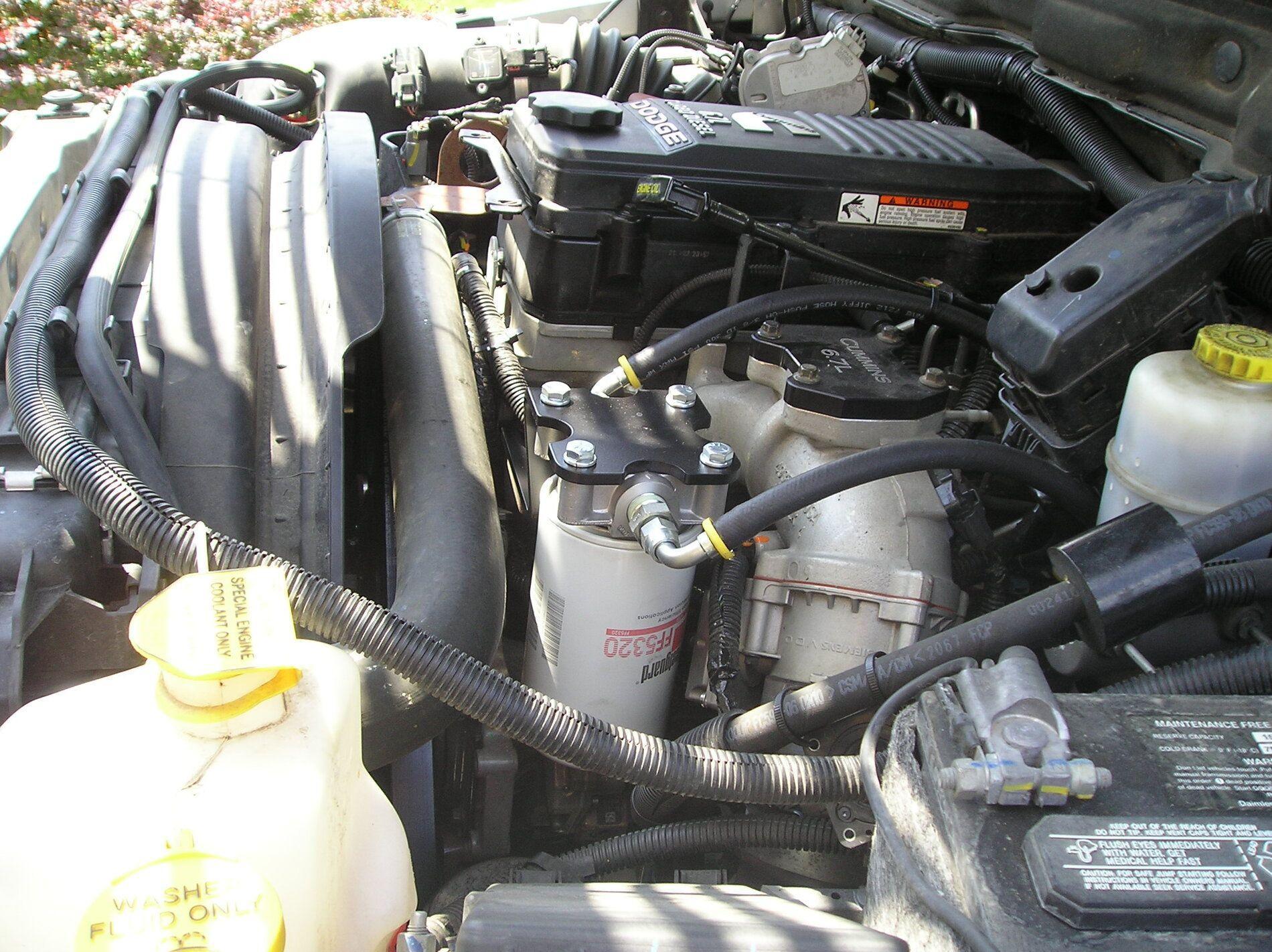

I have a 2008, with the 6.7L Cummins engine, I too have added extra filtration to my fuel system. I do purchase one of my fuel filters from Geno's garage and the other filter from Glacier Diesel Power. The engine mounted filter is a 5micron filter and the secondary is a 2-micron filter (not absolute). I purchased my kit from Glacier Diesel Power to add the secondary filter. See pictures attached.
For your needs and year of engine the fuel filter mounted at the engine is a 7-micron rated filter part number FS19856 from Geno's garage for $15.95 + shipping. If you use the Cat fuel filter remember the 2-micron filter is not absolute. I believe this is around 5-micron absolute filter.
