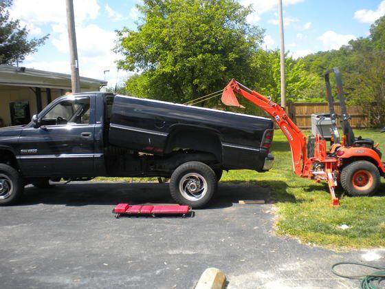

I have always lifted the bed rather than dropping the tank. Easier for me.

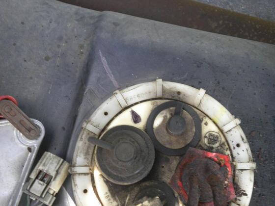

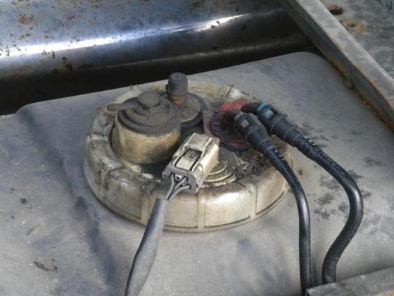

My truck had the "bouncing" fuel guage, figured it was the sending unit. Wrong! It was the lines on top of the tank rotted out! Had to replace the entire in tank module because it was rotted in half and the guage was just flopping around in the tank. I replaced the fuel lines from the tank module to just in front of the tank with rubber, since the lines beside the tank (much like my brake line) had also rotted badly.
I did a powerpoint of the thing, if you PM me with your e-mail address, I can forward it to you, not sure if I can post a powerpoint here or not. Also, here is a picture of the top of the in tank module, what a beauty!

OK, I got the powerpoint sent out, I hope! Let me know if it didn't work. I thought I would load a closer picture of the top of the tank, you can see better how bad it was. Still puzzled about the in tank module rotting inside the tank, but what are you going to do? Also, I cheated, I used my little backhoe to lift the bed, HEY, I'm old, full of Arthritis, and grumpy, what would YOU do? :-laf

That's been my motto for several years now!!!!! I've taken tanks down half full, I don't care HOW careful you are, it's gonna hurt! I like the ATV stand idea, that may work better, but considering, the backhoe was easier. Gotta admit my neighbor was more like :--)
