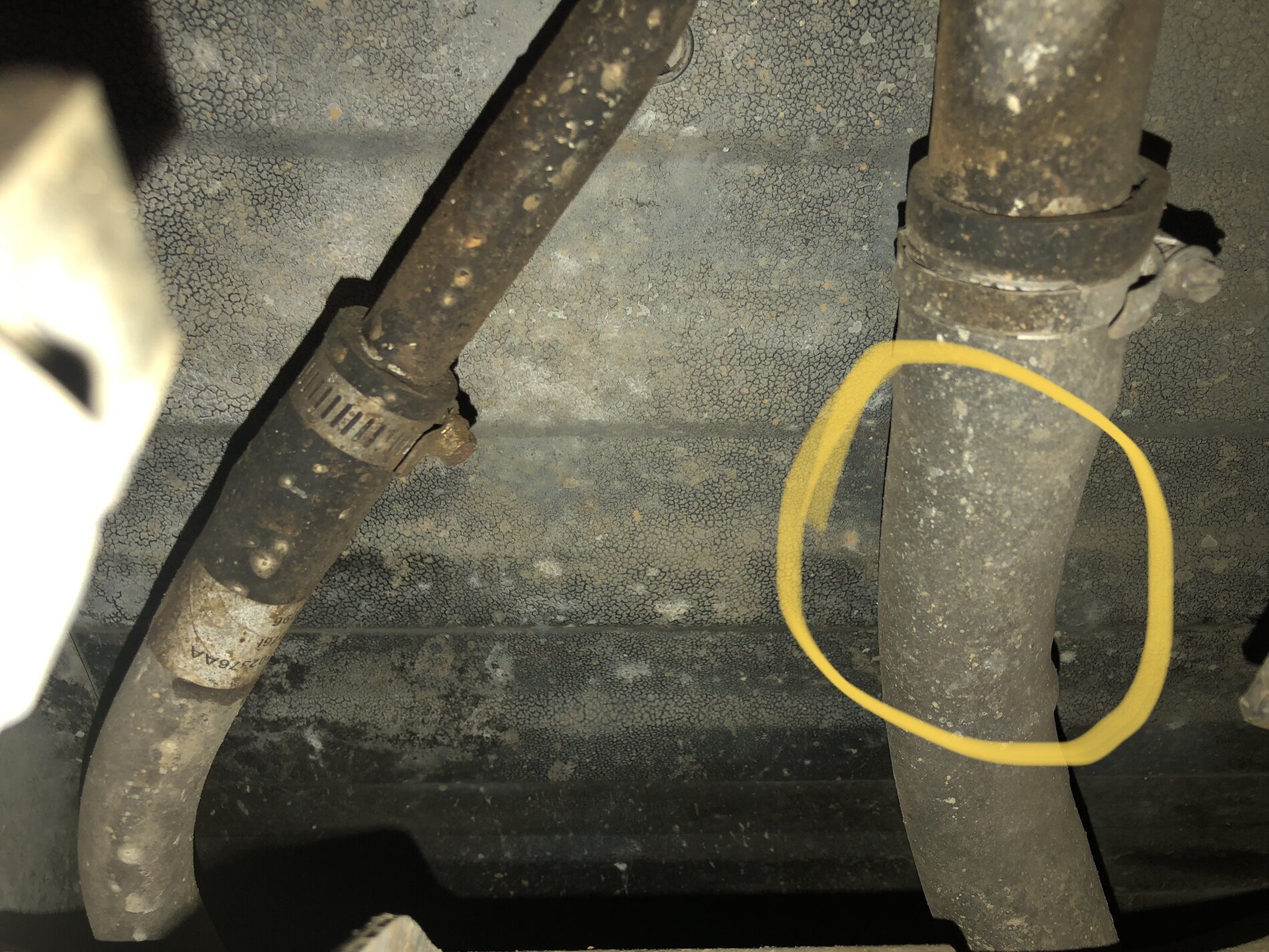

Is there some type of valve on the fill line? I’ve heard there might be an anti siphon screen of some sort. Any way to break through that screen?
I’m trying to plumb in a fuel pickup for my camper diesel heater. I’m hoping to just tee in and run a hard plastic line down into my tank. Thanks.
No restrictors, screens or the like in the fill line. If you are looking to draw fuel out, you may consider a draw straw or bulkhead fitting on the top of that tank / module which will guarantee you have the ability to draw fuel at any tank level, If I am understanding your post, you want to modify the gravity fill adaptor and drop a tube into the tank? While it may work, two things could occur, one it that the fuel line could restrict the flow of fuel into the tank causing it to be difficult to fill, especially at truck pumps, and second as I mentioned, there is no real way to guarantee the pickup is at the lowest point in the tank.
