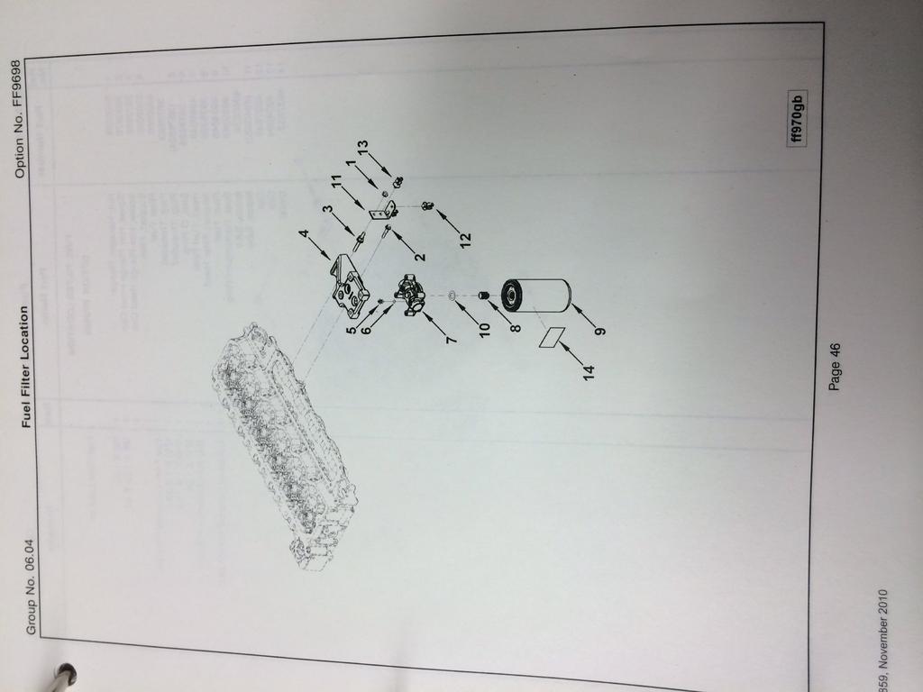

This is really becoming a rhetorical mess. Need to get back to the OP. I will finish up by stating that I too have 30 years in the auto/truck/marine/fleet maintenance business. I hold no degree but I study and hold in my head designs I come across. I'm not a grease monkey- I thoroughly understand what I do and why it's done. I understand that there are many versions of our beloved common rail cummins. I understand that the Ram version of the 03-07 engine has it's filtration system spec'd by Dodge. I was surprised that cummins allowed it, but after all, it is/was Dodge holding the warranty bag on it. In 2003 Komatsu used a version of the 5.9 in the WA580 wheel loader. This CPL includes the engine mounted final filter in the diagram above. This was after a 30um racor Water sep. THIS arrangement was certified and warrantied by cummins. Far as I can tell, it's plumbed similarly to the GDP et al.

Not sure what you mean by it being a rhetorical mess. It is about facts which are apparently inconvenient with personal views. Mounting a filter to a vibrating engine WILL reduce its performance. I’m always amazed at the pushback this fact produces. The physical world is what it is. You or I cannot change it by wishing it were different.
Is a larger capacity 2 mic filter mounted to a vibrating engine better than the stock 7 mic mounted to the same engine? Most certainly (as long as the stock filter’s water separating ability is retained somewhere in the system). Is it ideal? No. That is why I’m suggesting to the OP that he not mount the filter to the engine while he is still deciding what he wants to do.
I think he's considering his options. Regarding vibration- in the big picture, the ISBe is a pretty smooth engine. Everything is a trade off. You can do an off engine remote mount, but if it will be based on GDP idea I feel there will be too much flexible line (a liability) and it may need to be mounted lower than it needs to be, causing more stress for the CP3. In this case you might see problems if prime is lost for some reason.
