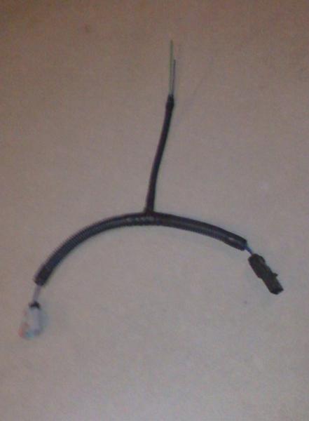

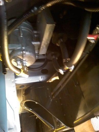

Awesome, Ok you tap the power wire to the factorcy Module Pump (Power)? I hope transflow supplied a Harness like this 1, I made the 1 pictured for My dual pump bypass/additional filter lift system.
