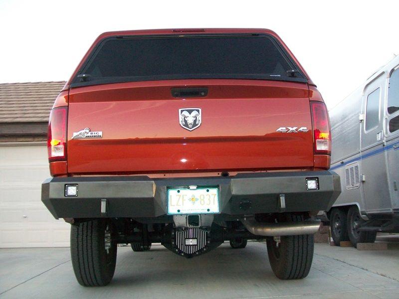

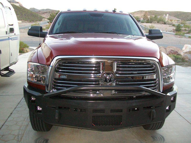

Just finished the Fusion bumpers with Rigid LED lights on my 2013. Excellent fit, quality bumpers. Lights are really bright.
Is there room for a winch behind the front bumper? Doesn't look to be the case, but curious just the same. They do appear to fit the finish of the truck nicely, Thanks for the pics.
Installation was very straightforward. The style I got isn't designed for a winch, but they can make them. However, a winch will impede airflow to the low mount intercooler unless it sticks real far out, and you run ducts, etc. for airflow.
Love the pearl coat. It makes the color look different depending on the light. Mine is light gray stone pearl and changes from gray to tan/goldish depending on the light.
Stevie Wonder could drive with those Rigid's. Looks good.
The back window of the shell matches the curve real well too.

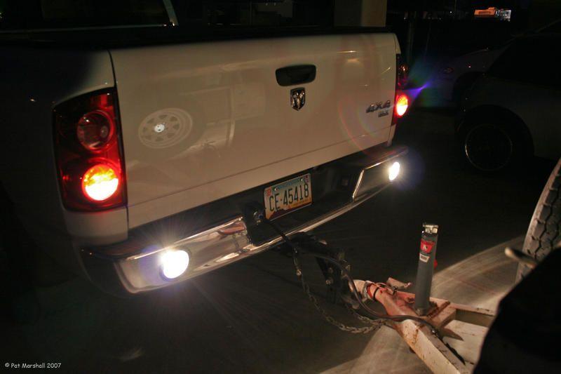

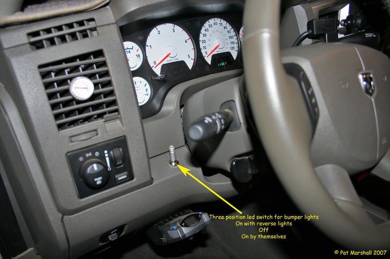

Nice job Joe! Good motivation for getting the install completed on Red Ryder. I ordered the LED bolts for the license plate, just need to get the Rigid LED flood lights and I'll be set. I think I will wire the back up lights so they come on in reverse AND have the ability to switch them on to provide light when hitching at night without having to put the trans. in gear.
Not to hijack thread, but that's what I did back in 07' to aid in hitching up trailer in the wee hours of the morning.

Joe those look great, did you go with the flood or driving light pattern? I am putting the 6 LED flood version in my Iron Cross rear bumper and the 6 LED driving pattern in the front bumper just wondering how you like the pattern that you chose...
I have the 60 degree diffused LEDs in the rear. In the front I have a pair of spots and a pair of floods, all the Dually series from Rigid.
I don't drive on highways with the lights so I haven't had any issues. They are EXTREMELY bright and the fronts are wired into the fog lamp circuit. They draw less power than the factory fog lights.
