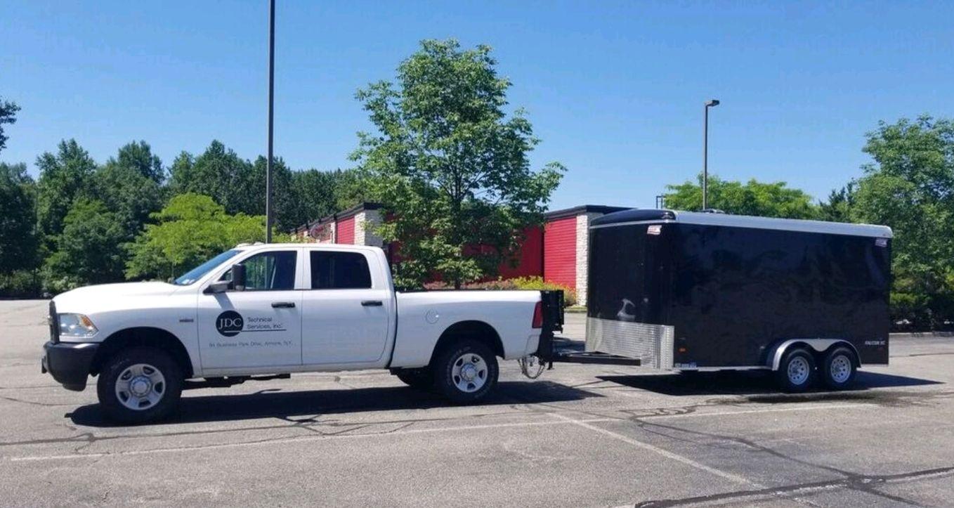

'18 2500 6.4
Camper no problem, firewood no problem.
GN +15k on it, it's at the higher end for sure. It would be pushing my personal set up.
My truck is right about 8k full tank, 2 people, empty, but have a Tommy Gate on the back.
I would say don't let the regen stuff scare you away, just figure out a way to run it well a few times. Sometimes folks don't run the DEF topped off if you won't use it that much.
Cost wise you might not see a payback on the diesel, but residual value is usually not used in alot of that math, IMO my 6.4 vs a CTD resale I'm losing that 4k pretty quickly.
I got mine with some good options 4.10s, LS rears, SnoCommand package, work Vinyl, have the lift gate, so it's exactly what I needed, no regrets on my buy at all.
7x14 Enclosed, pulls it very nice.

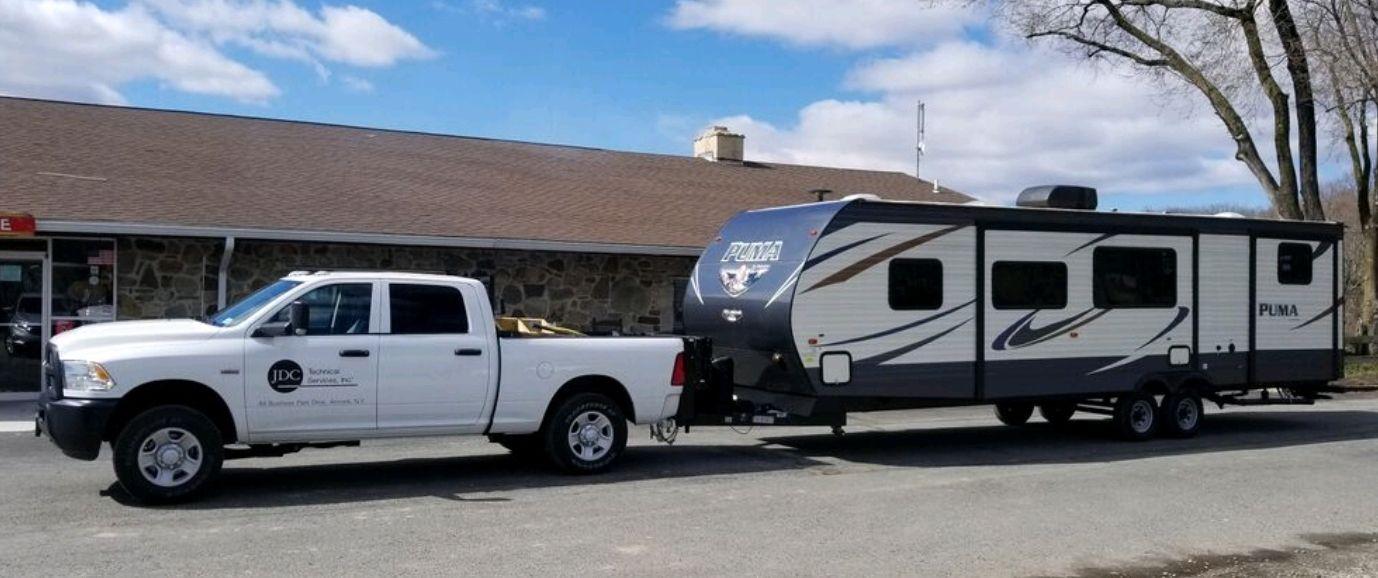

34' Camper, no issues at all.

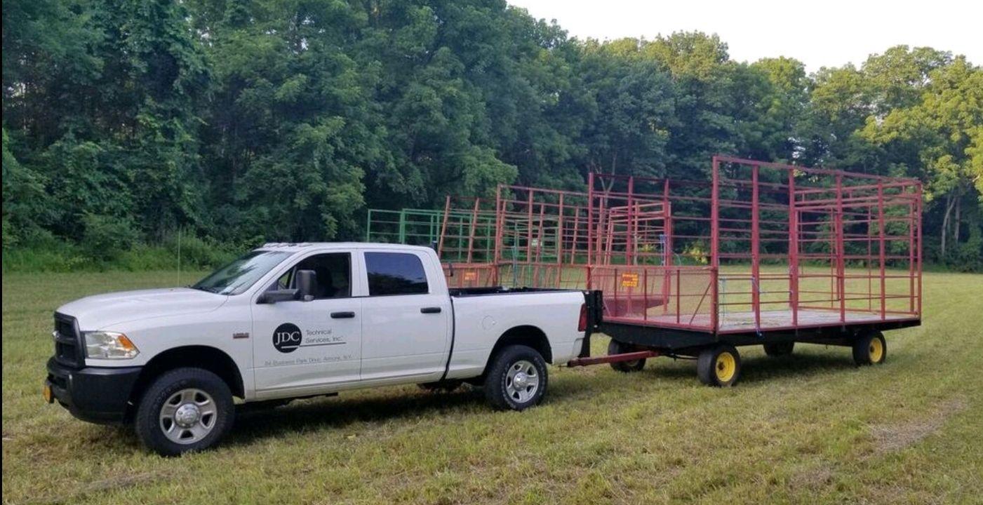

Hay Wagons, we usually get 150-175 bales per wagon (avg 40lb per bale)
