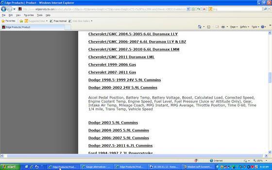

Here is what the Edge will read on a 2000 to 2002 CTD. I don't know why Edge couldn't take 5 seconds and do it for you... :rolleyes:

Anyway, the info Mike shows is good. They're fairly decent on the 2000+ trucks, and do a good job with fuel economy. Their later models of Juice with Attitude come with an array of adjustable parameters and screen options.
If you just want the guage options with no fueling mods, there is the Edge Insight, a standalone monitor screen, Part #83830. It only reads the operating parameters, displaying them on a color screen wherever you want it. Here's the link on Edge's sight: http://www.edgeproducts.com/product.php?pk=145&pvk=405 If you go down midway, you'll see the (Click Here to Supported Vehicle Parameters), and you can click there and scroll down to the 2000-2002 Dodge, which will show you the parameters you can read.
Now, IIRC, I believe you have to have the Juice w/Attitude to get the fuel pressure readings but, all in all, for the price, the Insight's not a bad deal. Much easier than installing guages. I believe the EGTs are an option, but you have to have the EGTs read seperately through a probe, though, as that parameter is not read by the PCM on the Dodge until '07. That's gonna add close to another $150 to it's cost, which retails around $415. I'll try to get ahold of someone in corporate and check on the fuel pressure reading. It may be available through a seperate sensor... ... Wish me luck. As a MVP dealer, I still don't get much respect. :cool:

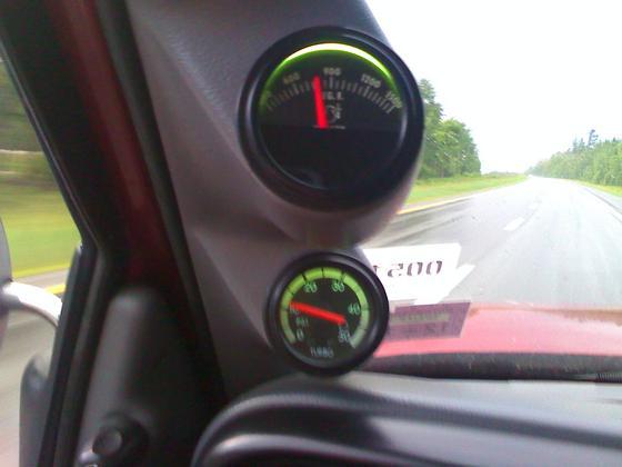

I just prefer guages. I have a two pods on the door pillar. Look great for the 2nd gens. I have boost,egt and fuel pressure.
