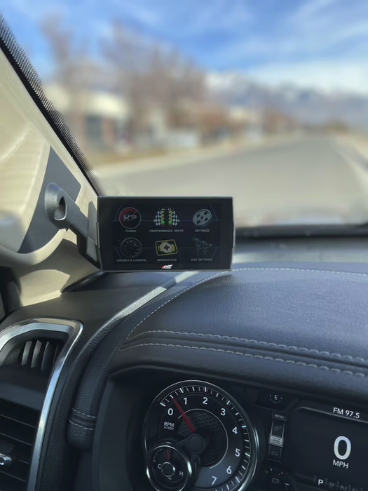

Are you looking to install separate round gauges? There isn't much in the way of mounts for the newer trucks. The best option would be an Edge CTS with the bracket that Genos sells that mounts with A-pillar screw with ball mount. I used that style bracket in my 2014 to mount a Garmin GPS unit in drivers lower windshield. Other option would be to get a Dash-Mat and use Velcro on the bottom of gauge pod to hold in place. With the Edge unit, it allows you to monitor a lot more Pid's that are in the truck. Hope this helps.

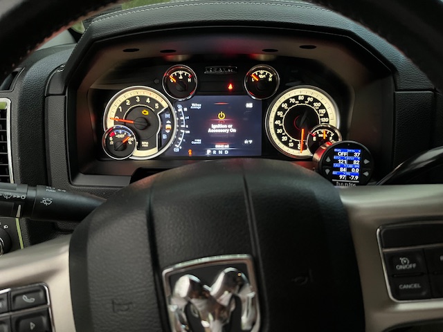

Where did you install your EGT & Transmission Temp Gauge? Any Pics?

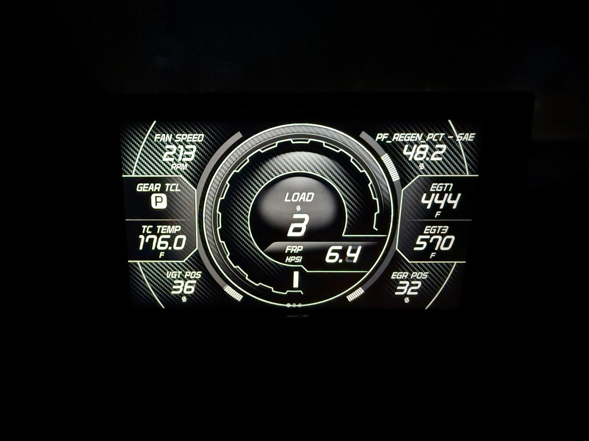

Edge CTS3

Get a CTS3, it’s a much nicer product and better display.

Piece of 2" PVC pipe profiled to fit the lower corner of the bezel. Held in place with 3M double sided tape. Fits a gauge perfectly. Black rattle can. Would be easy to do a second on the other side if needed.
It keeps the dash clean. Well, until I put the TPMS monitor up there for the camper and the trailer rear camera screen. Oh, and the video screen dashcam rearview mirror...
