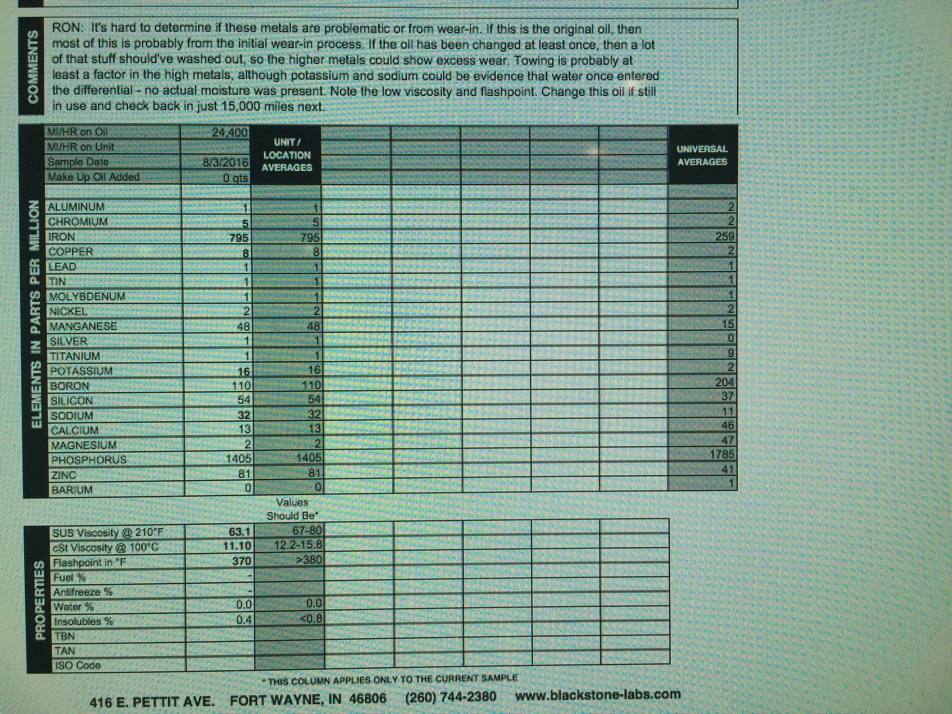

At 20k my fluid was TOAST!!! When towing taking off turning the rear started grabbing similar to being on a hard surface in 4wd. I had the fluid tested and it was BAD.
Running AMZ/OIL SevereGear since with zero issues. I use the 75-110 since I tow heavy at 33-35k combined.
