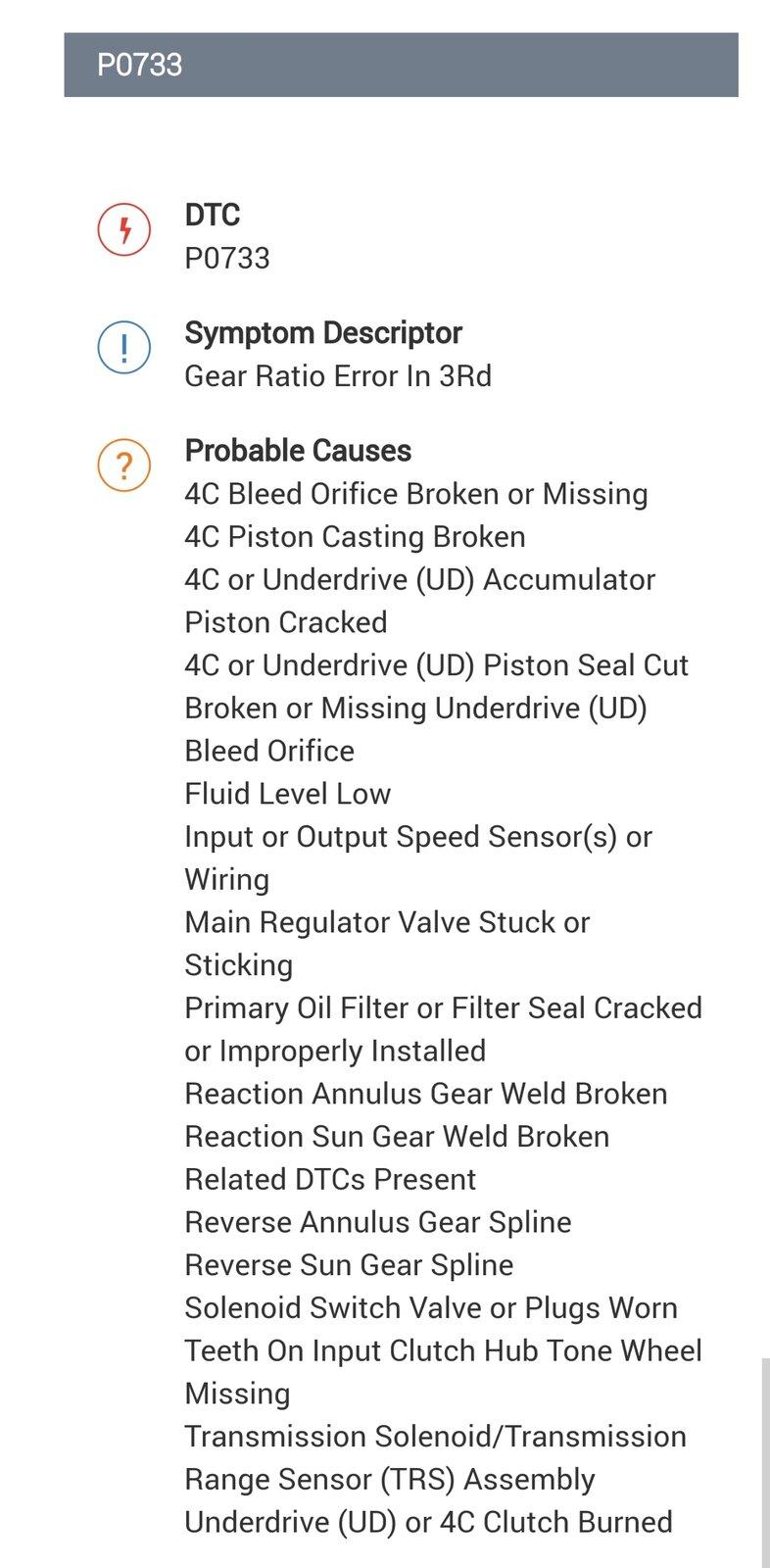

Yesterday out of nowhere I threw a CEL P0732(Gear Ratio Error in 2nd) and the truck went into limp mode. I did a one time reset and of course it came back. I also got P0734("" in 4th) and P0733("" in 3rd) today after driving it gently a bit.
I have a tuned truck, and do a decent amount of boat towing to add context to the workload on the transmission, additionally it's a 68RFE. The truck has about 145k miles on it.
Hopefully someone knows some info on here that might help me get some insight and determine what my next steps might be. It may just be bring it to a shop but I'd like to try and figure out some info about what's going on first... thanks in advance to anyone who can help...

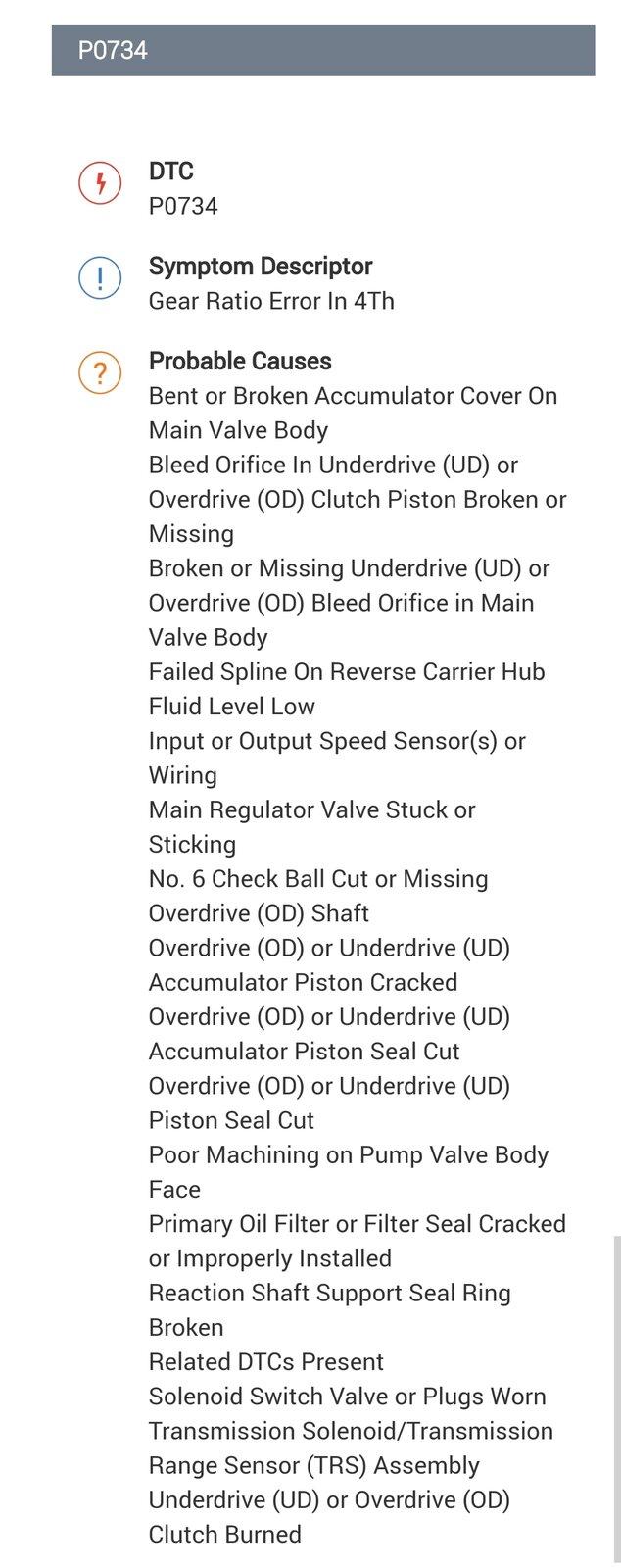

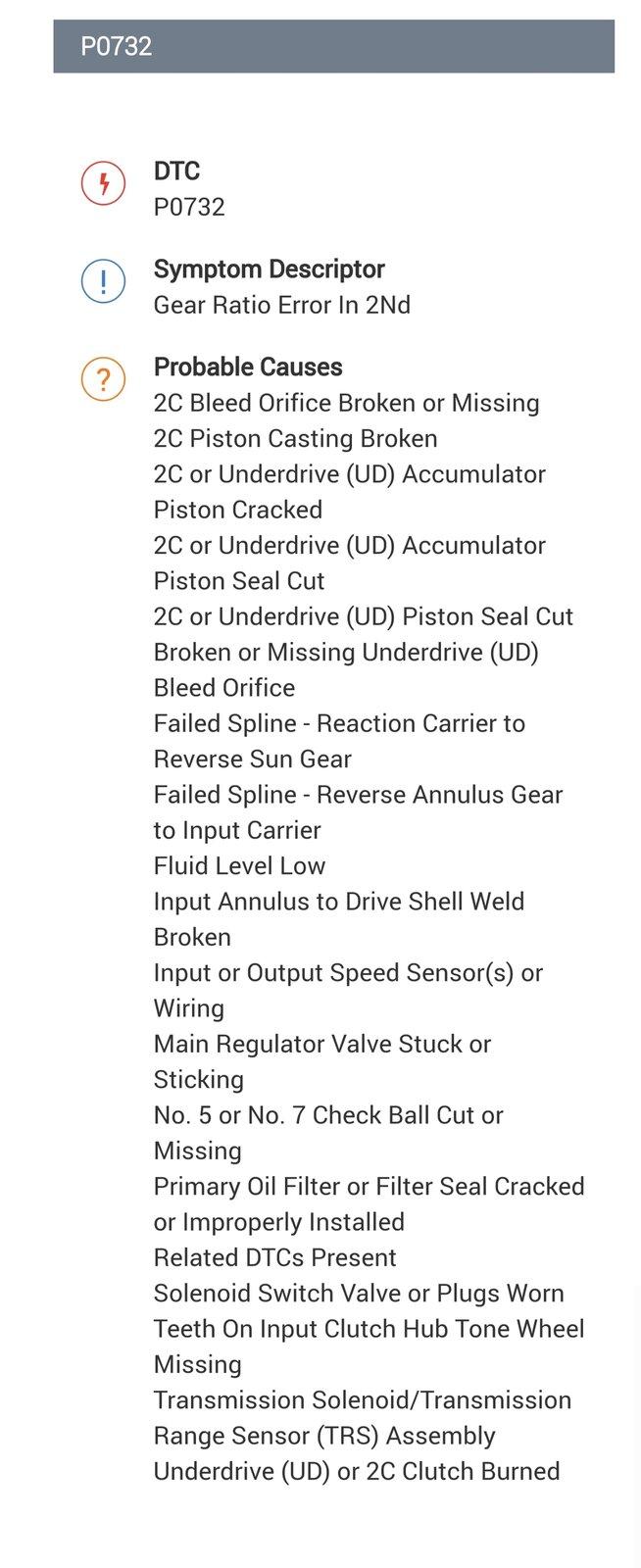

Simple common point is Fluid Level Low, also one has a broken or cracked filter, with improper seal on filter.
I feel I have read that before on these the filter housing can break. Again just a WAG, someone can correct that, I seem to recall you have to just becareful to get the filter seated properly.
So you could do some real simple checks.
Then it's all looking at common points off the screen grabs, or wait for help to arrive. There are some pretty slick 68RFE folks lurking, just need to lure them out with some bad info to correct...... I'm thinking let's not start with the Failed Spline on the Reverse Annulus Gear to Input Carrier.....

I could not do it, but look at the above stuff and manually check the common issues, then can kinda get a rough idea.
I tried and the screen shot deal just does not work for that long of a post.
Unless you know you broke it there are some items there you can address for sure. Then you just need to figure out if any of those can be eliminated.
