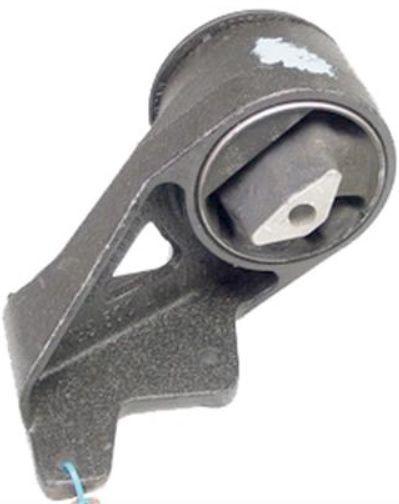

Has anyone ever installed new motor mount insests ?
I bought a set from Prothane with no instructions ,nothing
On line or on you tube etc . I called the tech support and the guy
Said to take out the inner tube ring and now it fits too loose ,
So that is a obvious mistake ,any ideas ?
I just found out , so does any one sell replacement rubbers ?
$55 for a decoration is nuts !!! These mount inserts should say theyare not replacement parts
I'm going to say the rubber is bonded into the metal part of the mount and you have to replace the mount. The Prothane pieces are to firm the stock mounts up.
Summit Racing shows these Anchor Brand mounts for $32.00/each for '94-'96:
