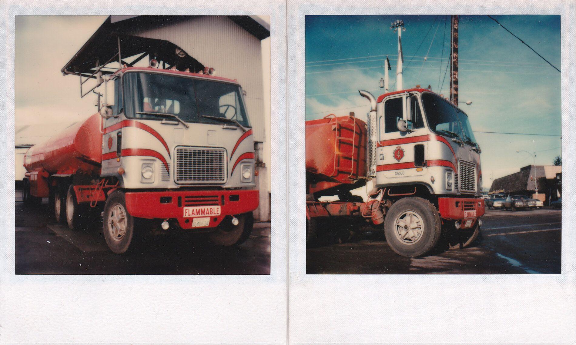

I delivered gas to the Texaco in Forks, Wa from Sept 1976 to Sept 1979. Right hand photo is at Forks, left one is in Port Angeles tank farm. BIG Chevy truck. 350 Detroit and 13 speed roadranger. It had been a Stroh's Beer truck/tractor! SnoKing
