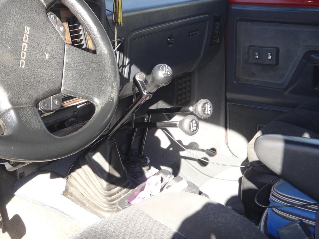

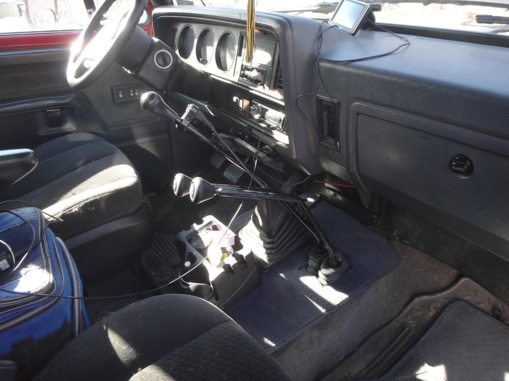

The Getrag was a ok trans and if the case is not damaged there and you dont plan on turning the truck up a lot or towing heavy you would be fine getting it rebuilt but a NV 4500 is a all round better trans especially if you want to add power or tow a lot. as for looking factory here is my truck with a 4500 in it

When i converted my 92 you could not tell the floor was cuyt its only a few inches i just screwed anouther peace of sheet metal then used silcone to add a peace of carpet that matched the oem carpet
