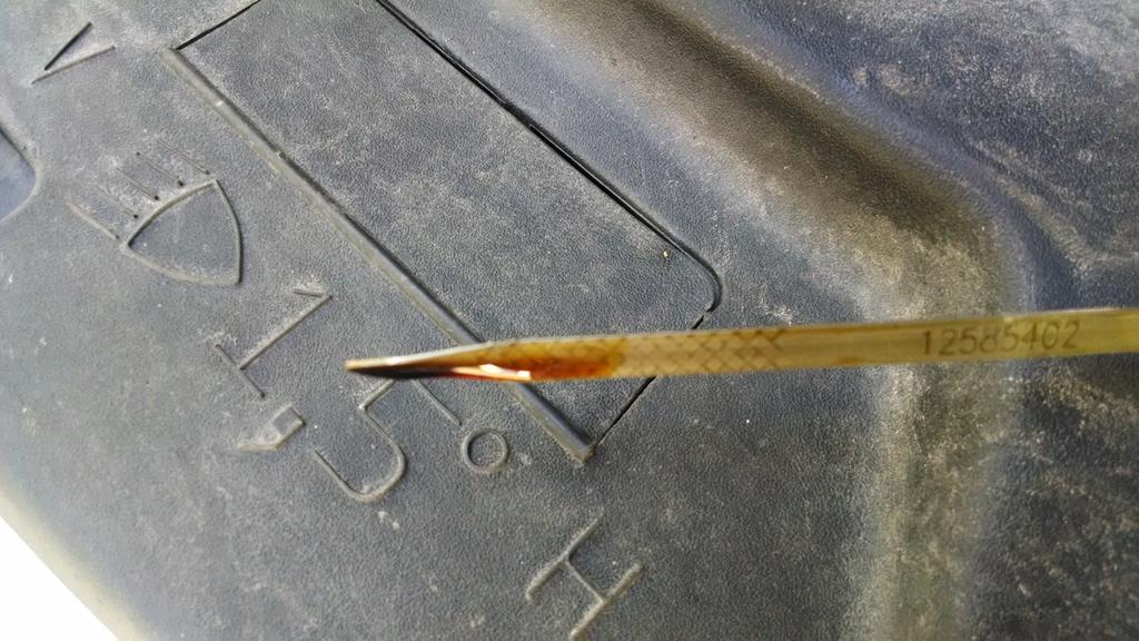

Well, at the 11,000 mile mark I just couldn't take it anymore. This is the oil level and color of said oil with 18% still showing on the monitor.
I think 11k was long enough. I've had a truck or car in my family get up to 5,000 before I got 'round to changing. That's the longest I've let one go. Just my $0.02
Vehicles/oil change intervals: Chevy Cruze-3700; '06 Toyota Solara 5k; 97 Honda Accord 4500; '93 CTD 4800; '72 VW SuperBeetle 2k (new engine/case).
