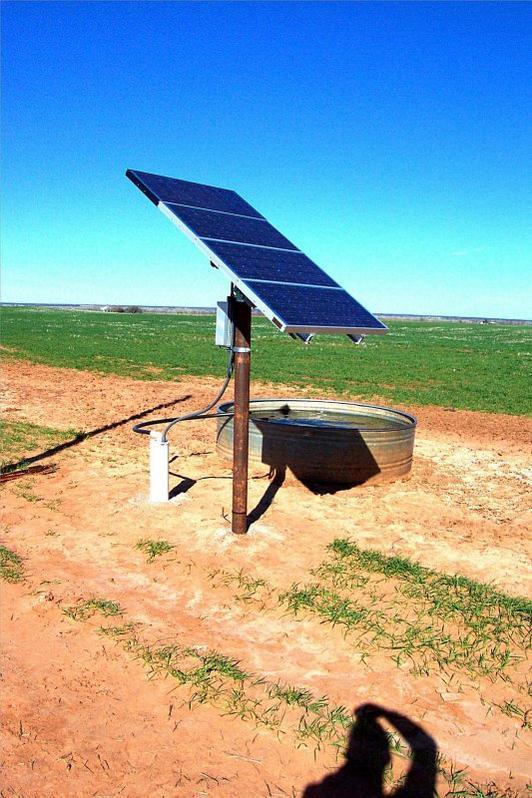

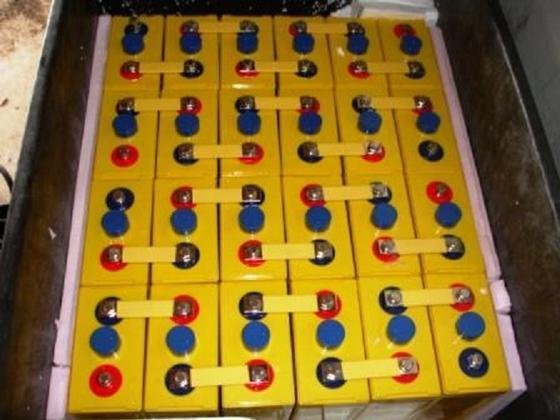

Think you have battery maintenance problems?? Not a problem yet and wont be if the maintenance is done on a regular schedule and care is taken to get it right. Solar Systems for homes are a real option. And can be used in place of older less reliable methods for the same purpose. I dont like the batteries that are used but I DIDNT BUY THEM so its a good chance to test another product to see, after all they will have to be replaced SOMEDAY. Son and FIL have been working their TURNIPS off at the Son's new place getting ready for the 7mo winter. Have new cattle coming in this week and are going to need someplace to wet their whistles
