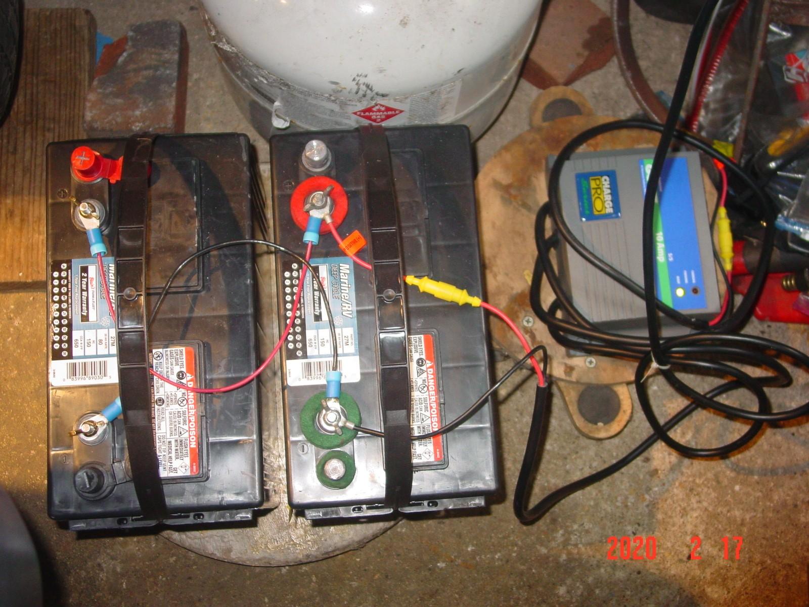

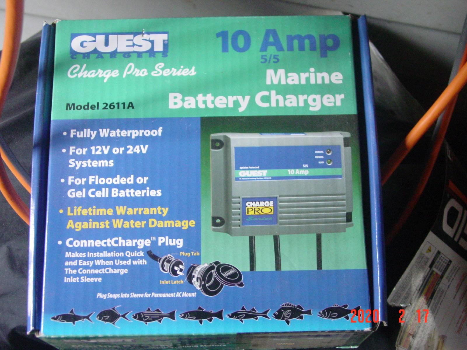

Greetings; I've been using this "Guest" marine battery tender from West Marine, for my boat & RV batteries during the Winter here in Wis. Here's a pic of the box & one of the RV batteries on the garage floor. (for now). A 2nd batt tender is in the boat for its batteries.
Like the man says, ya needs a buddy to keep the water from drying out. Good luck.

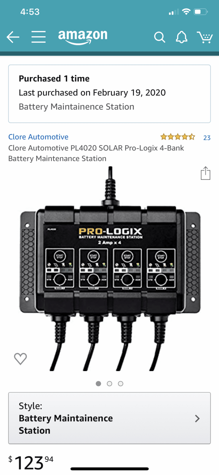

We, or at least me, was thinking you were just going to put it on your truck with the batteries installed. If so, you just need one charger hooked to one battery since they’re connected. One charger will charge both at the same time.
DO
NOT connect one bank to one battery and another bank to the other battery unless you at least remove the crossover cable from the passenger side battery.
If you’re going to remove the batteries and you have another to charge, the 4-bank is what you need.
DO
In a recent brain fart, I did just that to my truck(i.e. 2 individual battery tenders, one hooked up to each battery) The truck sat that way for over a week and they seemed to charge the batteries normally with no ill side effects to either the chargers, the batteries or the truck, which I have driven since.
That said, I am curious as to why you think it is a terrible idea??
