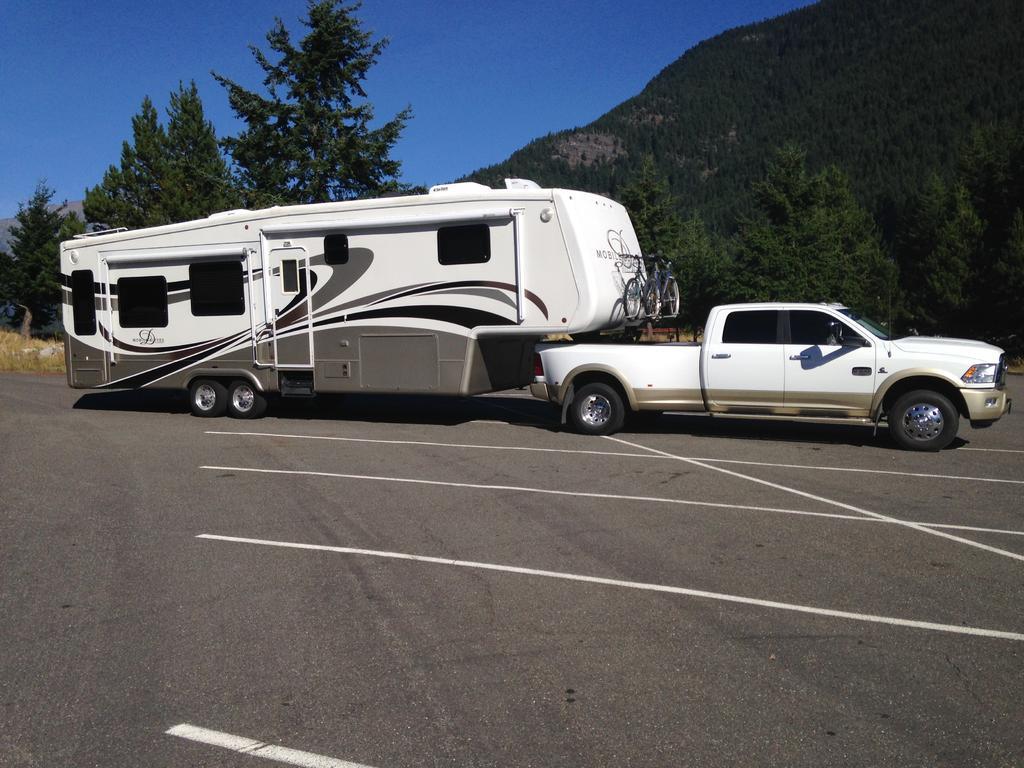

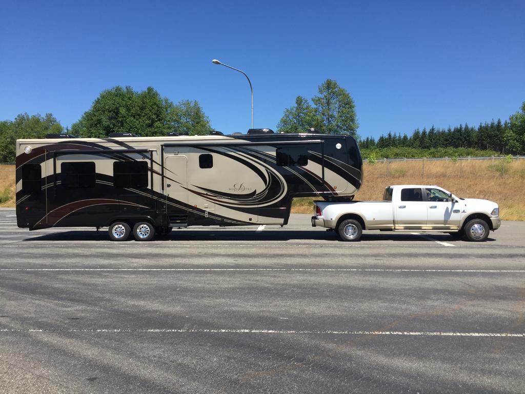

I think bit has more to do with the gearing/weight. I was not saying it's the 68RFE at all. If it had the same starting gears and I had 4:10's in last truck I don't think I would have any shudder. If I eased into the throttle it did not happen but if I gave it the juice from the start it was not a happy camper.
Here is a pic with my last combo and current one.
