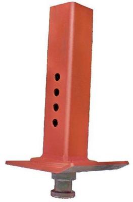

Hey Big, how about going the other way? If your goosenecks have the round or square adjustable insert, get the fifthwheel type, there will be no loss of integrity of the hitch. Then just keep the fifthwheel on your truck.

Here is a picture of one.
Nick
Big, I have never used one, I don't have any fifthwheel hitches, however I can not see any weakness of the design. I can see where some trucks/fifthwheel hitches might be too high, that there might not be enough adjustment on the trailer to keep it level.
