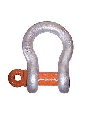

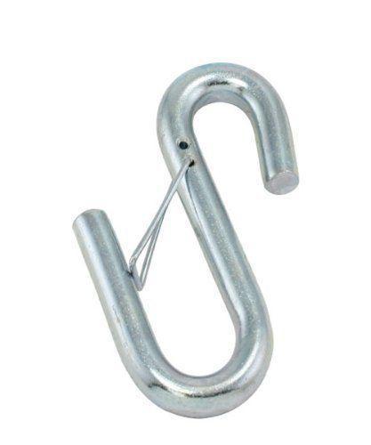

I have a 2016 3500 and tow a horse trailer.the factory devices in the bed are nice but cant find hooks to connect to them.i have found hooks that will go through the opening but none have a safety clip to keep them from vibrating off.HELP
Maybe a shackle like this?

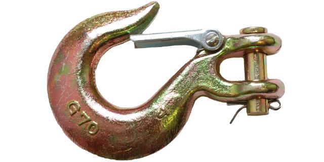

Or this....don't know how big your eyelet is but this is a pretty good sized one. This one is for 3/8" chain but they also make them for 1/4" and 5/16" chain as well.
7600# each and had some tie down chain from when I was a REAL TRUCKER and got tired of throwing GIANT iron for flatbed work. Mine are a gold color as is the chain I believe that's the special high strength alloy that's used (I couldn't find an example online)
works great for my 2 different gooseneck trailers and B&W turnover
I don't think the throat is wide enough for the cast attach points on the factory GN prep package. My PJ came with hooks like Mike recommended and I still had to take 1/4 inch off he safety latch to get it to close around the tie down.

The color is not because of the alloy, it is a zinc/chromate coating for corrosion resistance.
The color also indicateds that it is DOT Grade 70 chain.
"When to use Grade 70 Chain
When you need heavy chain to secure large loads grade 70 chain is the best choice. With the most efficient weight-to-strength ratio that comes from drop forging and heat treating, this truck chain allows you peace of mind that your load will be secured in place against sudden stops or tight turns where another transport chain could fail. Grade 70 chain and grade 70 chain hooks can be easily identified by their yellow zinc chromate finish and either 7, 70, or 700 embossed into the surface. Grade 70 chain strength is mandatory for auto transport chains, flatbed chains, heavy equipment chains, tractor tie downs, and log transport chains. "
Grade 70 and 80 transport chain will also be stamped every foot I believe with the grade. Will be on a chain link. That's how the DOT can tell.
