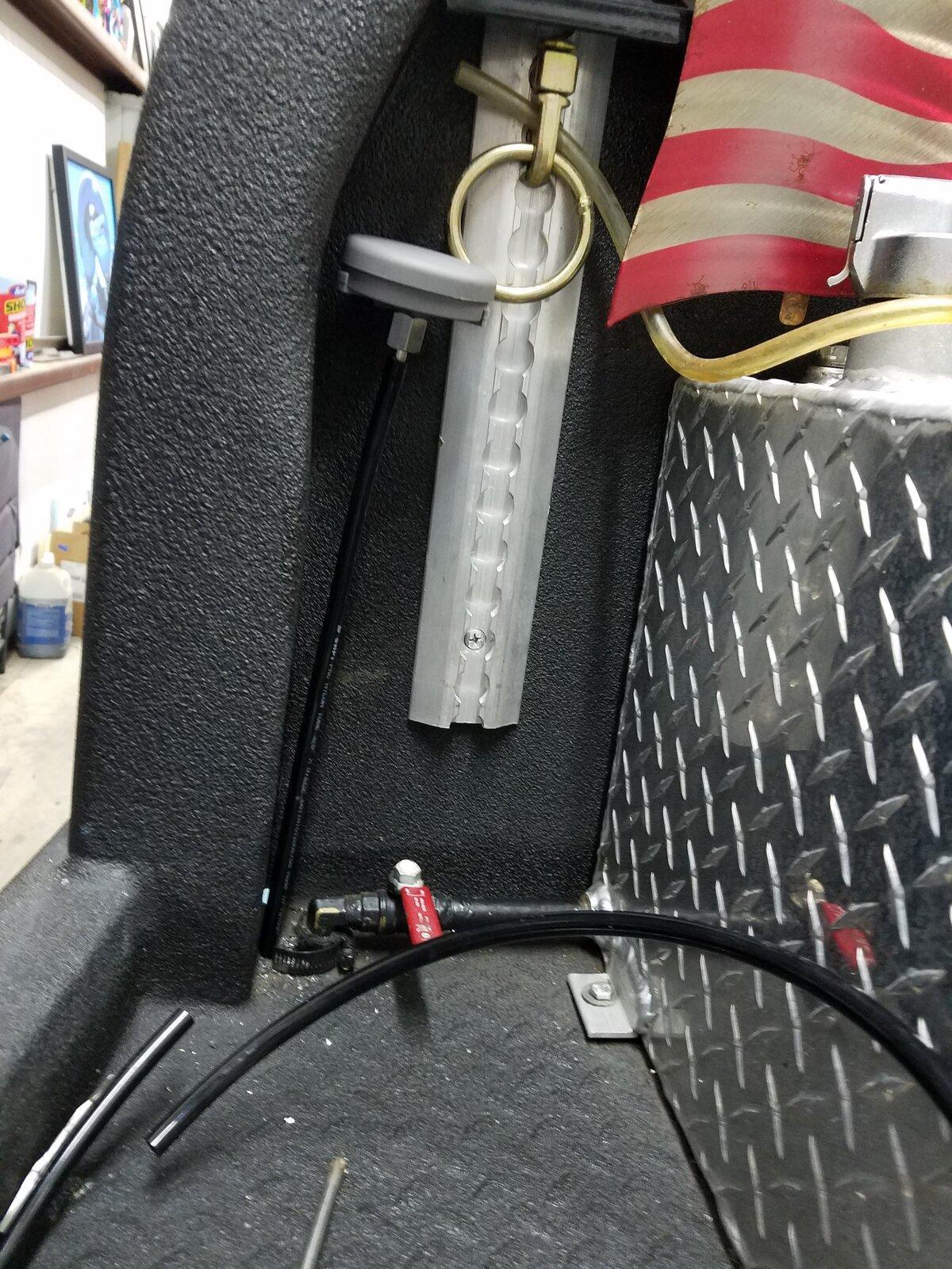

I have a 2019 3500 with an auxiliary 90 gallon tank. It is gravity fed and is always on. I’ve had similar on my prior three trucks and believe you’re better off without a pump. If needed, I’ll be happy to take a couple of pictures of the installation for you.
I have a 2019 3500 Ram with a 90 gallon auxiliary fuel tank. It is gravity fed and is always on. I had a similar setup on my past three trucks without any serious issues. I believe you’re better off without an extra pump. If it helps, I’ll be happy to take pictures of my installation.
