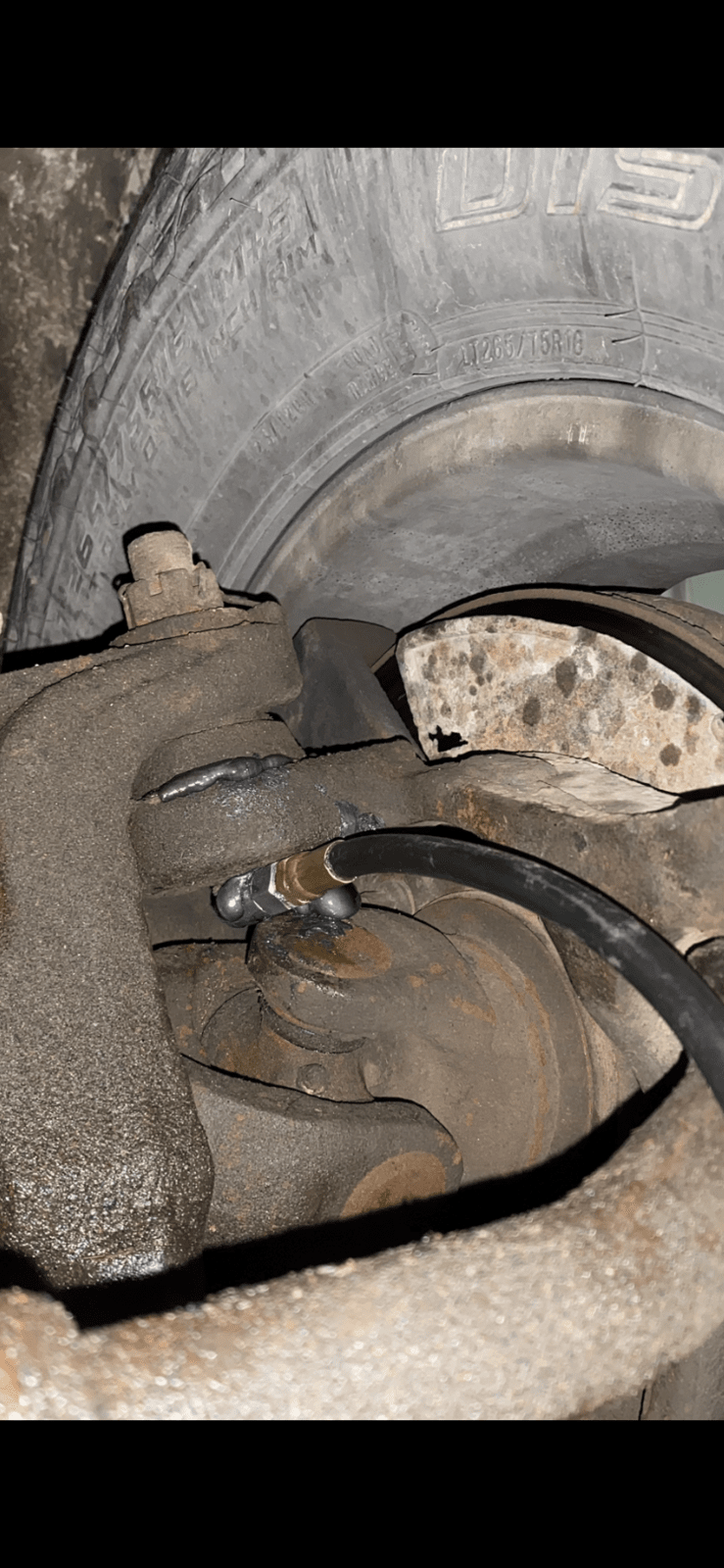

Have to Jack up the front so you can turn the wheel to get enough clearance between the axle and grease zerkTake the weight off the tire first. i always leave a dab of grease on the ZERK inlet.
