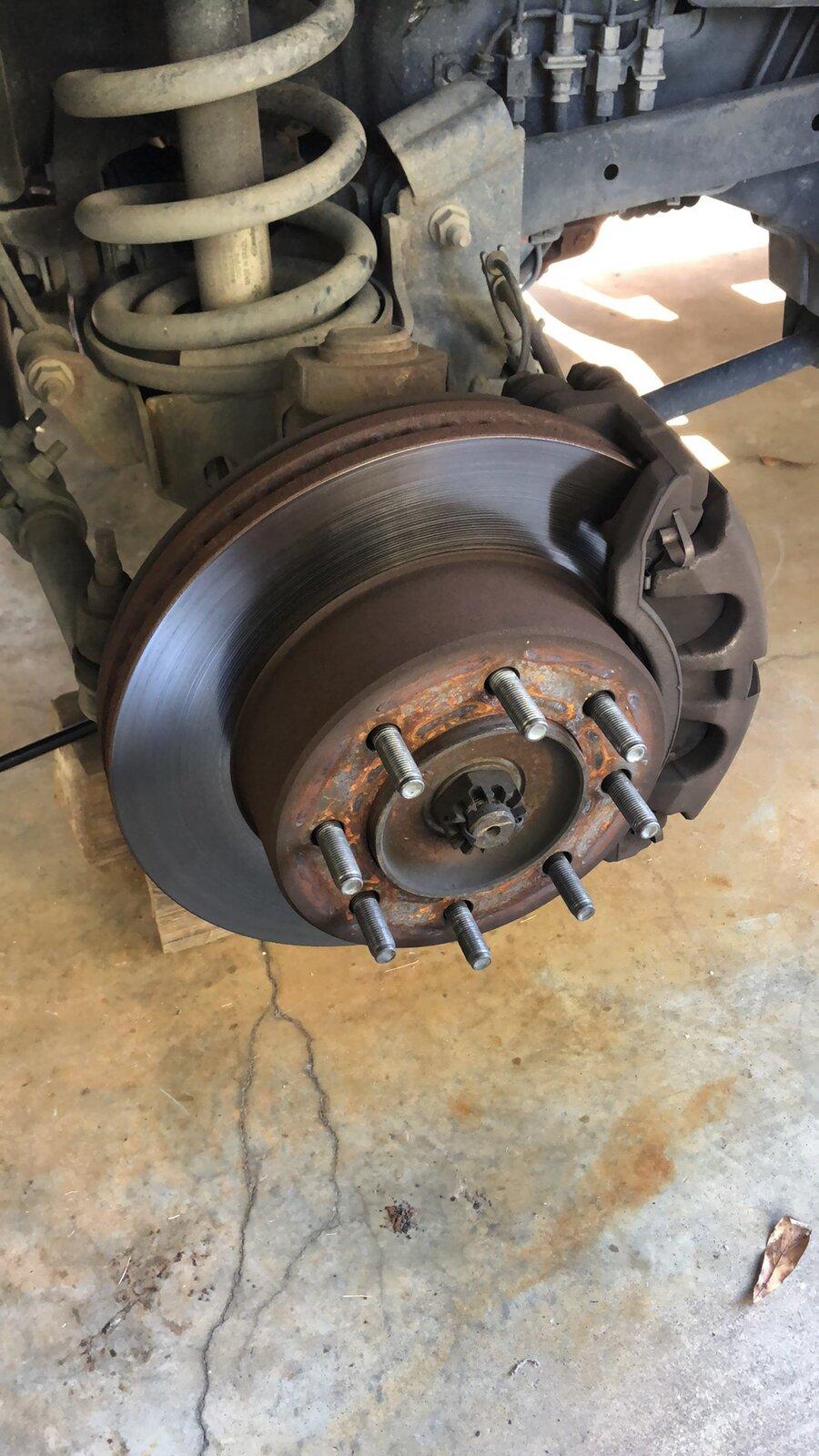

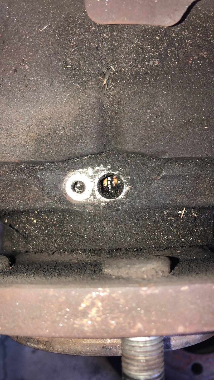

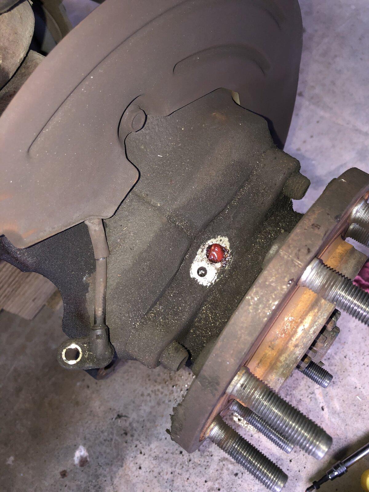

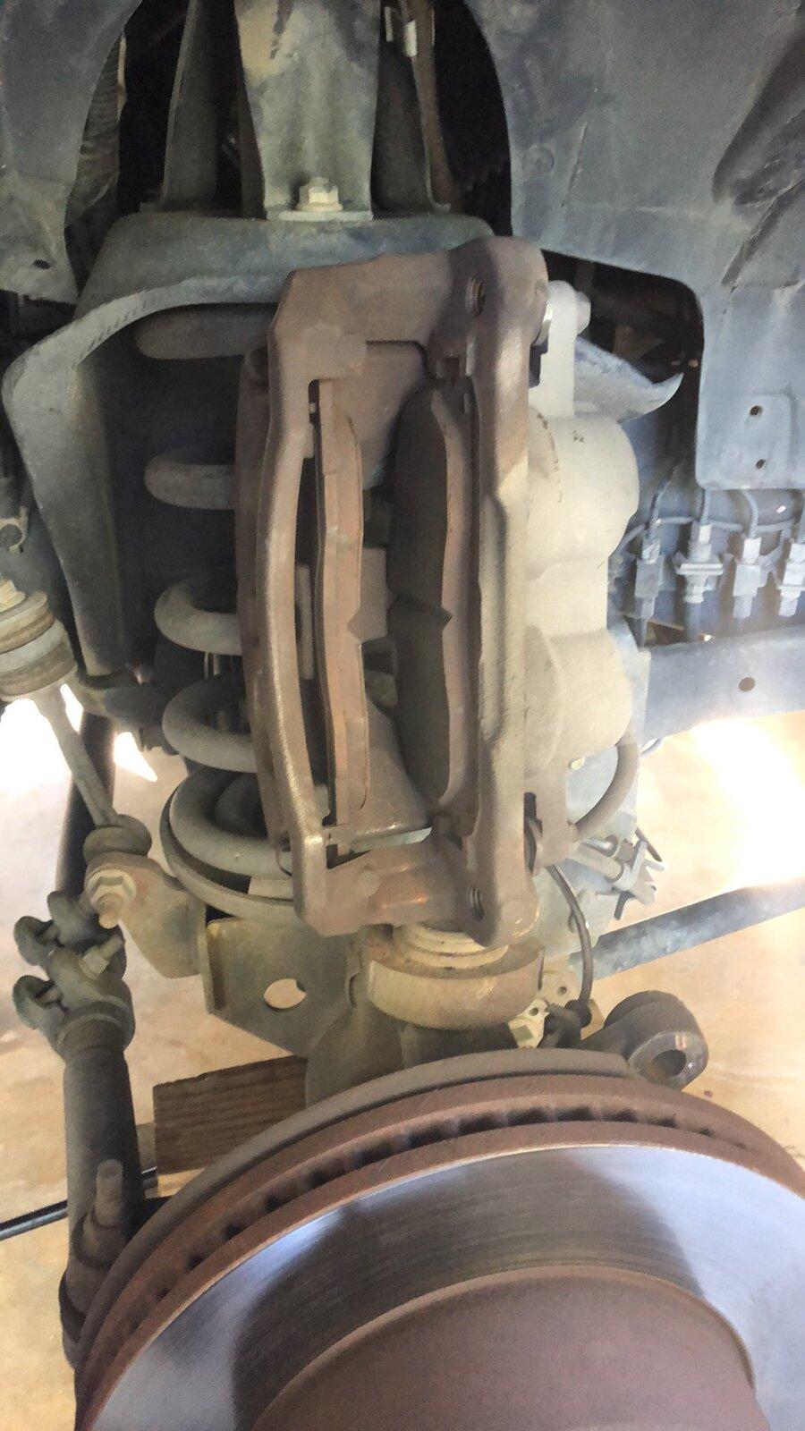

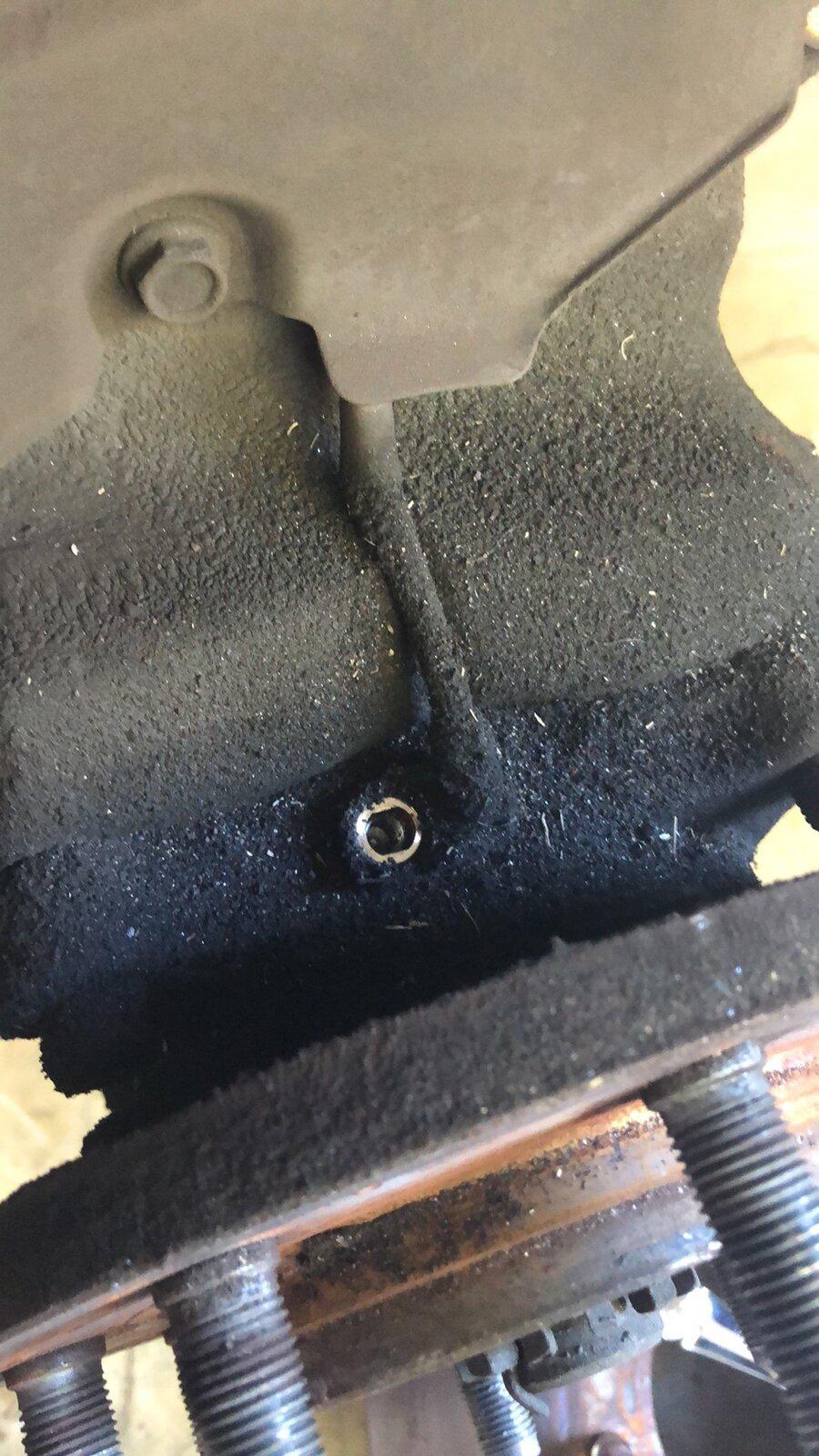

It’s been brought up a couple of times, but I wanted to post & share some pics of mine. I’ve been greasing my front hub bearings through the ABS sensor every 50k miles or so. They seemed pretty dry this time around. I was able to get 30cc of grease in each side. Easy project that took about an hour. I used a 20cc syringe, and filled it with grease from my gun then put the plunger back in & sent it while spinning the bearing. After about 30cc in each side I couldn’t get anymore in. All you need is a 7/8 lug wrench (impacts make it much easier), 15/16 socket for the caliper bracket, and a 5 mm hex socket for the ABS bolt.
Only other thing Id suggest is cleaning the area around the ABS sensor with brake clean before removing the sensor to make sure dirt does not fall in the hole as that will kill the bearings quicker then anything. I have never had a unit bearing fail that had grease added to it, they don't come with much out of the box!
