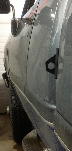

I installed the Happijac CA-FU on my 92 today. I wish the fronts fit better, i may end up taking them off and having them bent to fit better. They contact the bed corner. Install is very straightforward. I will use them with the camper next week.
