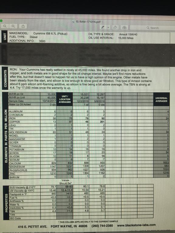

Happy with this!

Looks like my engine is doing well with 15K oil and filter changes. Oil is AMZ/OIL 15-40 100% synthetic with FleetGuard Stratapore filter. I added 1 qt last change at 10k on the oil. This time the oil stayed right on the full mark with zero make up oil.
