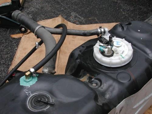

I saw a fuel tank vent mod that would allow you to truly top off your fuel tank rather than trickle the last 4-5 gallons in at a ridiculously slow rate in order to get it full. Has anybody done this mod or have any other options to top off my fuel tank? Yesterday it was sunny and I wasn't in a rush so I decided to fill the tank to the point I could see it at the bottom of the fill tube. I waited till the pump stopped and verified the fuel gauge read full then started filling it up slowly and letting the foam settle. It took almost 5 gallons before it got to where I could see the fuel in the fill tube. I had another 250 miles to go so I wasnt worried about it venting, just wanted to see how much more fuel it would take.

I did the mod. Works great.
I put the Fleece in tank pump in and performed the fuel mod while I was at it. I got the kit from GDP. It has taken me a little bit to retrain my self to fill it until one click and stop. If you go past one click then you will discharge it all over the ground. I don't let the wife pump the fuel as she could be an Olympic fuel pump clicker.
Something to note, If you do this mod and fill up then park on a steep driveway you might get some overflow as it really fills to the neck.
I also threw some 3/8 tubing on my rollover valves along with some cheap fuel filters to help keep debris from entering the tank.
