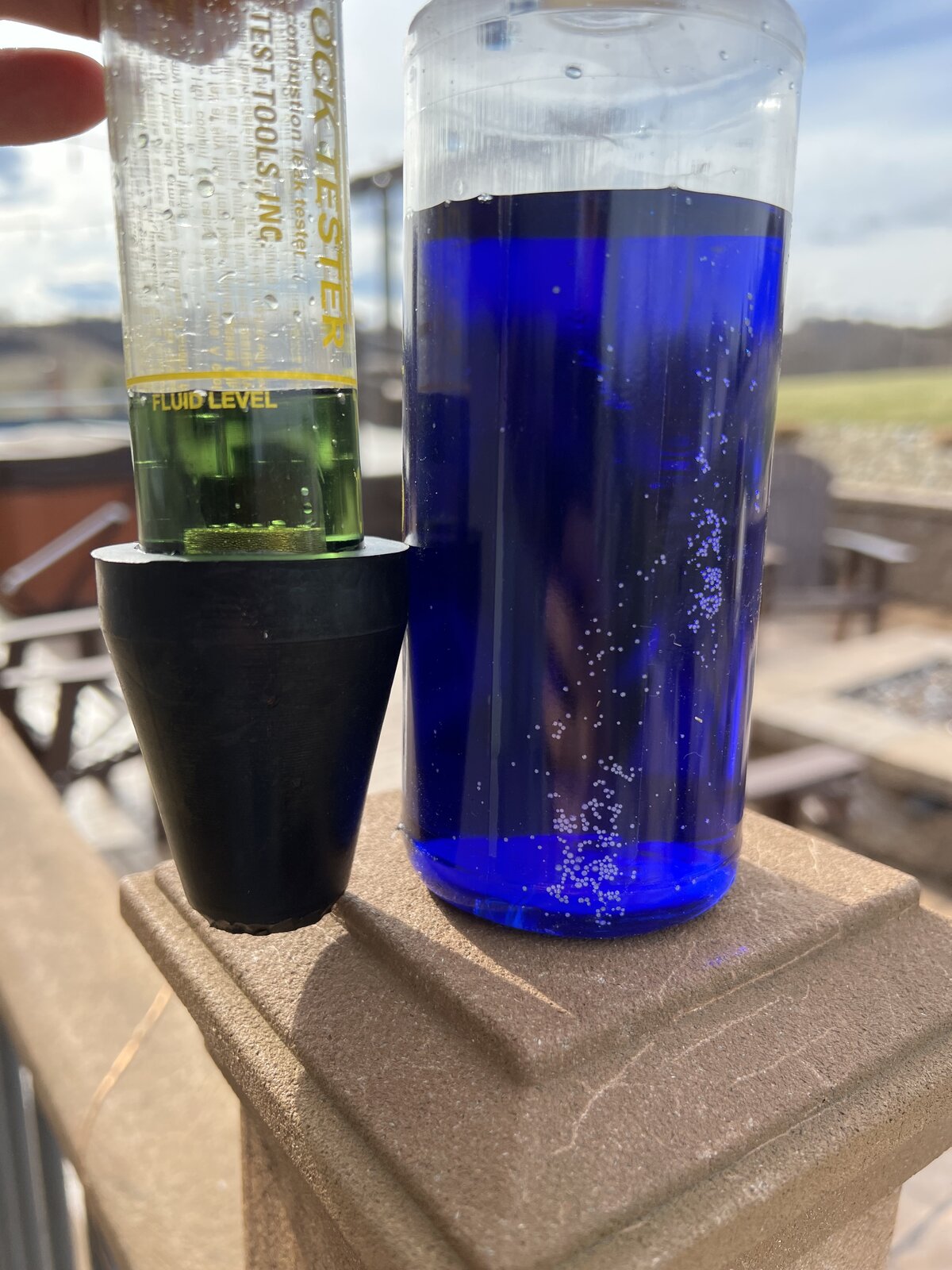

I replaced the radiator cap as suggested, no change at all. I also got a hydrocarbon test kit and did the test per the instructions twice. Attached is the color change, blue is the original fluid color and the green/yellow is the tested fluid. I understand that diesels may not have the same color change results as gasoline engines. I am also awaiting a oil sample analysis from blackstone.

What you mention here is a symptom of combustion gases leaking into the cooling system and forcing coolant into the reservoir. The coolant doesn't return to the radiator as it should when the engine cools after shutdown because the combustion gases inside the radiator contract, instead. Once the radiator seeks its own level, excess coolant will no longer be forced into the reservoir. However, if you top off the radiator, then the cycle will start all over again.
Try this. Don't add any coolant to the radiator. Make sure the reservoir is at least have full. Run the engine. Watch for a continuous flow of air bubble surfacing in the reservoir. Be patient and look for the bubbles under different operating conditions or engine temperature conditions.
If you do see a continuous stream of bubbles, that is a sure sign of a head gasket leaking.

Update: The head gasket failed in grand fashion yesterday. Noticed the truck getting hot while on the interstate, overheated quickly. pulled over let it cool off, only to find the overflow bottle completely full of murky white orange coolant and the radiator empty. Fortunately, I came up with a rescue plan...filled it up with water, drove it until it started to show signs of getting hot again, stopped refilled with water, etc. took 7 gallons to get me about 20 miles to home.
