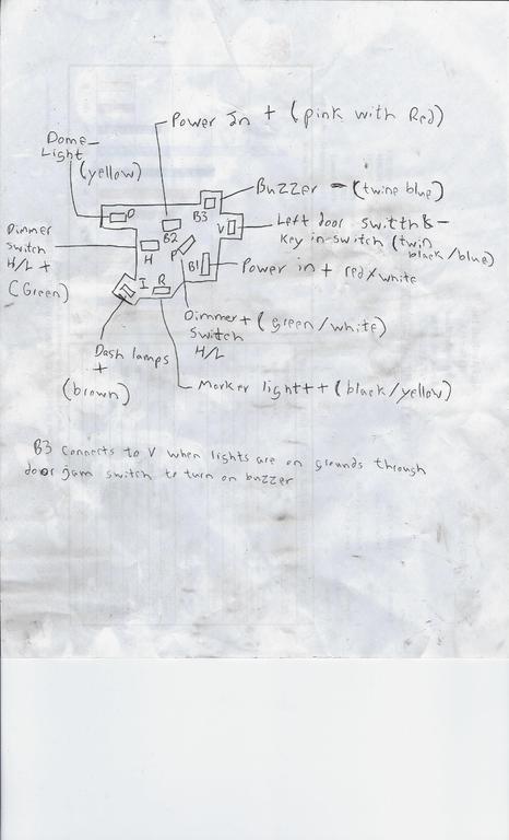

Head light switch plug

Hope this helps someone
I order two this past summer. One for the crew (may as well start off fresh) and one for the 90 as a spare. They are good quality. I would still recommend running lights and headlights on a relay though.
Good diagram Ray!
Good diagram Ray!

Yeah, same here. Melted several on the 90 in the last 12 years. Now all is on relay.
As for you Mike, meeeeeh why don't you just pull your lower lip over your head and swallow. :D:-laf lmao
I never even thought of relays I just got rid of the factory type switch, but the relays are a good idea.
Yeah, I thought about doing away with the switch. But then determined it was my running lights when I have a trailer on that was melting the unit. Second was the off road hella headlamps that would have been the second issue. So the relay solved both those issues and no harness to have to change. And that's a good thing. That is a ****ty area to get at. ;)
I burned one a few years back running 55w/100 bulbs in Cibie housings.
