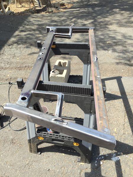

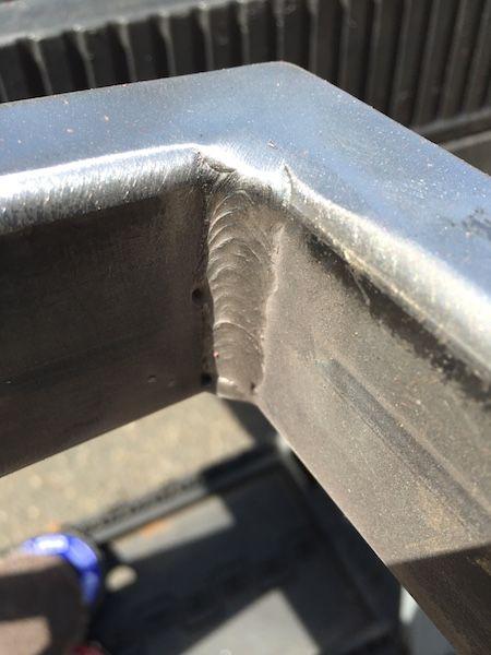

Got the ole flapper wheels out today with hopes to hide my bird poo welds. Cleaned up pretty well I think.
Speaking welds, here's the complimentary sample of my bird poo welds, Lincoln 256 mig with 0.35 wire and 75/25% gas.

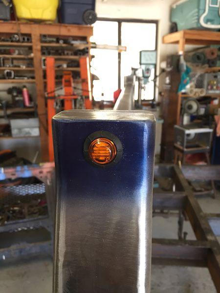

I bit the bullet and drilled holes in the stingers for my amber marker lights. Not sure that I'm in love with them, but I sure am not going to fill the holes in so they're staying.

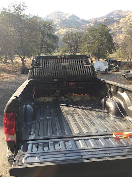

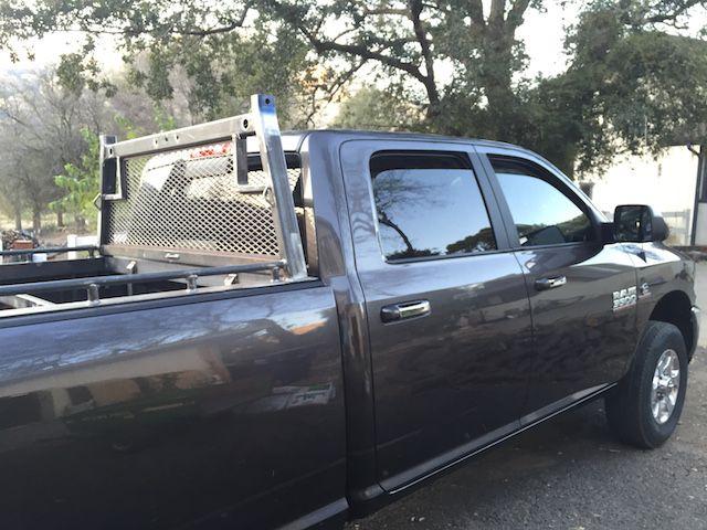

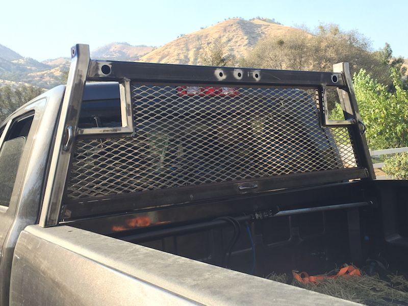

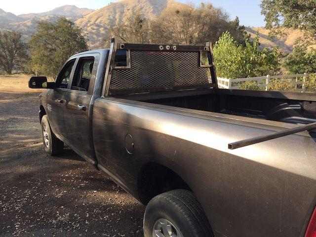

Couple of poser shots against the cab

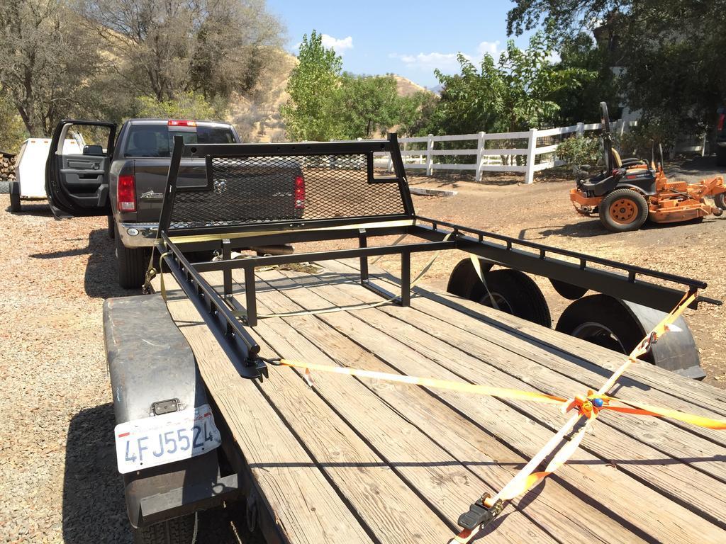

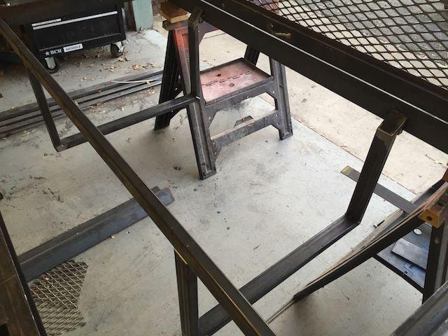

So I had a buddy come over this evening and helped me load the 3x3 angle frame onto the bed, and then we centered up the rack and tacked it into place. Only left is to cut the 1" solid rod rails that will run the length of the bed and attach to the lower portion of the rack. Was hoping to do that tomorrow but the costume shop called, so I have to go pick up my fireman costume and cover station 14 tomorrow from 0800 until the afternoon.
In the back, you can see the square tube that's temporarily tacked into place to make loading and unloading a little easy......er.

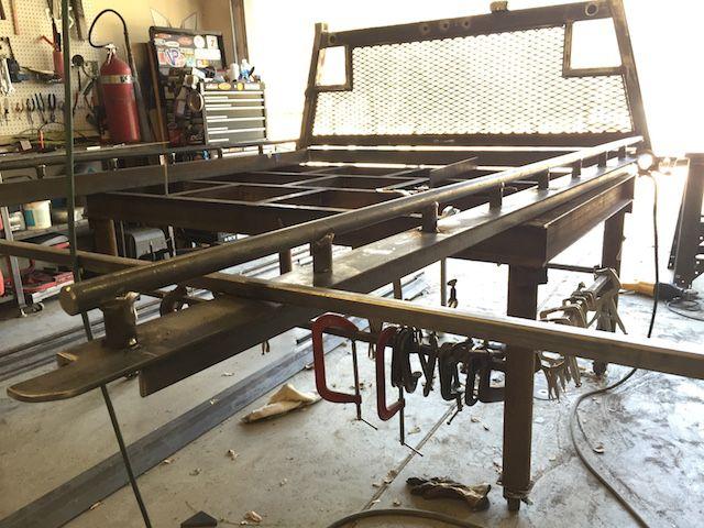

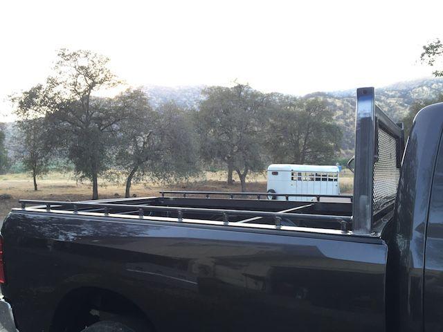

Worked a little today on the rack. All that's left is to build a cradle for my Pro Tech chest box to sit in. The chest will hang from the side rails so I can keep an open space below the box to fit full sheets of plywood or drywall underneath.

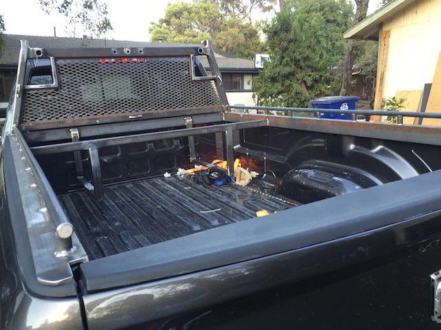

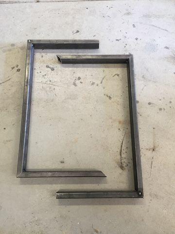

Well, today brought the suck to my project. What you didn't see once I had the 1" rails tacked into place, is that that I noticed the rack was 3/4" off perpendicular to the rails on one side. Don't expect you to understand that (I don't). All I know is that I spent the next hour cutting the rack off, and then some grinding occurred......lot's and lot's and lot's of grinding. Got that all back into place and reattached the 1" rails.
Then I went to work on the cradle for the tool box. All was going well until a buddy came with some silver bullets. I only had a couple, but I lost my focus and cut the long portions short by 1". So I made up the difference by adding a 1"x2" spacer. I got it tacked into position and soon realized that I had made another mistake. Oh well, I have to drive down to town tomorrow anyways, so I'll pick up another stick of 2'x1"x.250 and fix my mistakes later. I'm ready to be finished with this; yesterday.
I ended up rebuilding the cradle to the correct size so I could get rid of the spacers. Call me crazy.....
This afternoon I heaved up my tool box into the cradle and drilled/tapped some 1/2-13 holes to mount the chest. All that's left is to drill a few more holes for wiring purposes and send it off to the sand blaster Monday morning. I'm gonna pony up the money for a powder coat job. I've wasted and spent too much time on this stupid thing, so I think it would be dumb to rattle can at this point.
Wiring is going to be tricky simply because the openings are so small. I'm used to working with standard size trailer lights like the 6x2 ovals or 4" round fixtures that have a gigantic openings compared to these little LED's. Just will have to get creative when fishing the wires through.....

So excited! Powder coat turned out great. Now on to soldiering the wire harness up and finish installing the lights.
That looks great! How much do you think it weighs? I've got plans to build a rack for my pickup when I get some time. I just haven't decided what it will look like, yet.
