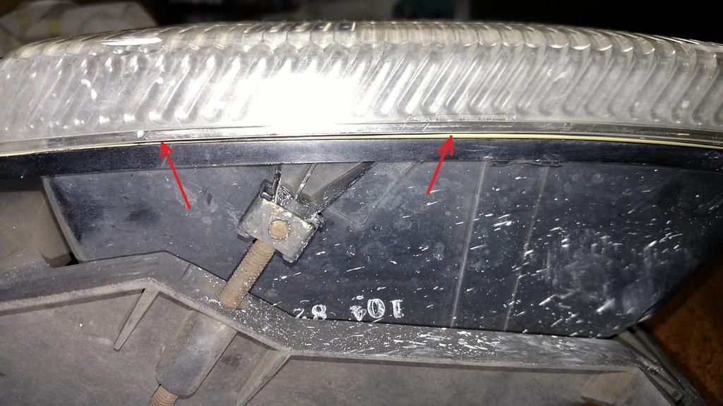

After removing the headlight assembly and carefully inspecting where the lens mates to the reflector, you can see where the lens is starting to separate from the reflector. On the three assemblies I've seen this happen to, it has been on the bottom of the lens.

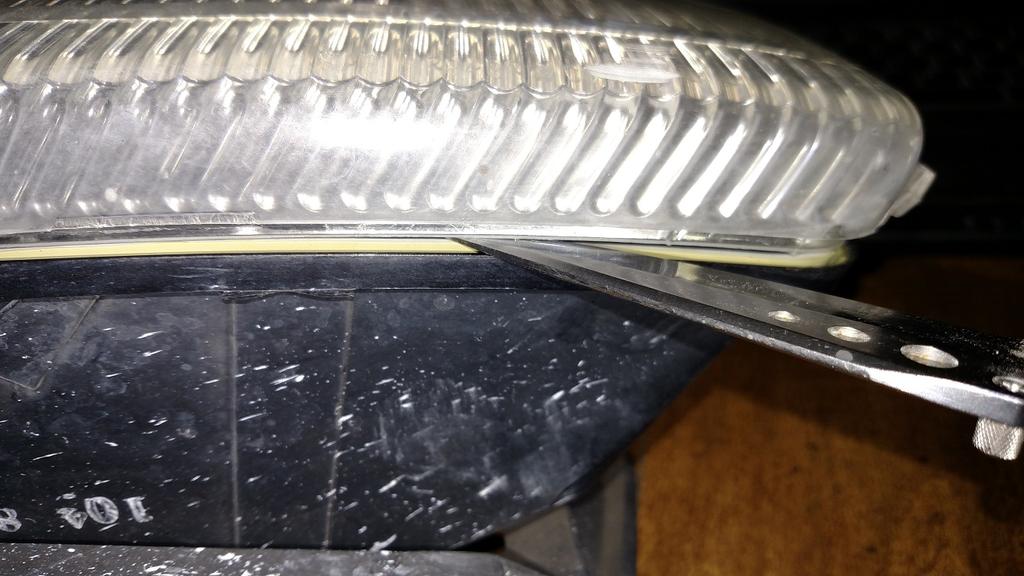

I carefully insert the sharp edge of my knife into the gap and gently pry it side to side enlarging the gap. Continue this around each corner, then the ends, then the other corners, and finally the other long edge.

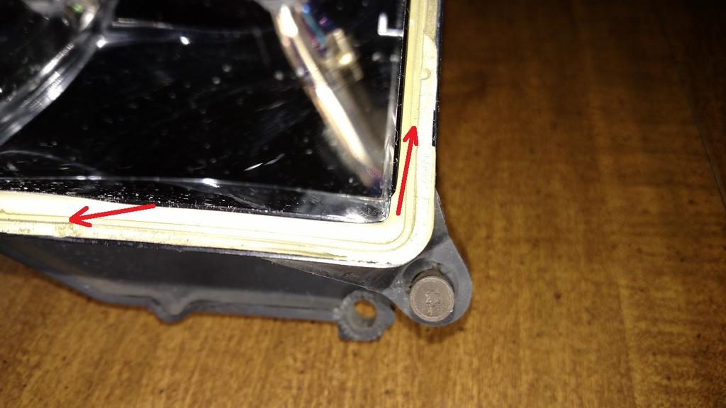

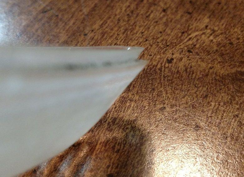

Take note, the edges on the ends that mate together are not straight down but at the same angle as the ends of the lens, so you will need to pull the lens away from the reflector at that angle.

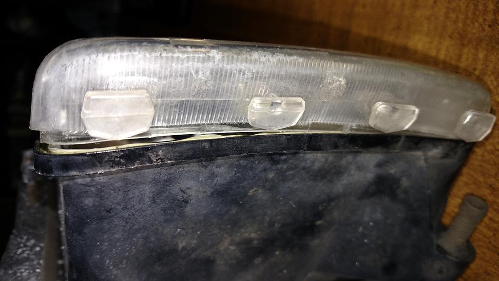

This will allow you to totally separate the lens from the reflector.

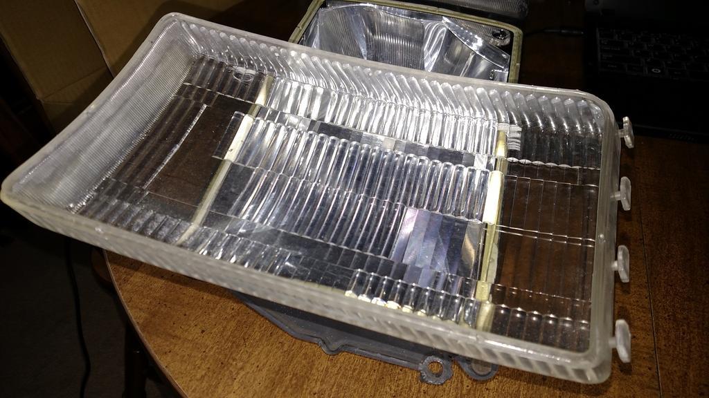

I have had success with this procedure three times. It's not hard and as long as you realize the angled edges on the ends it would really be hard to break anything.
