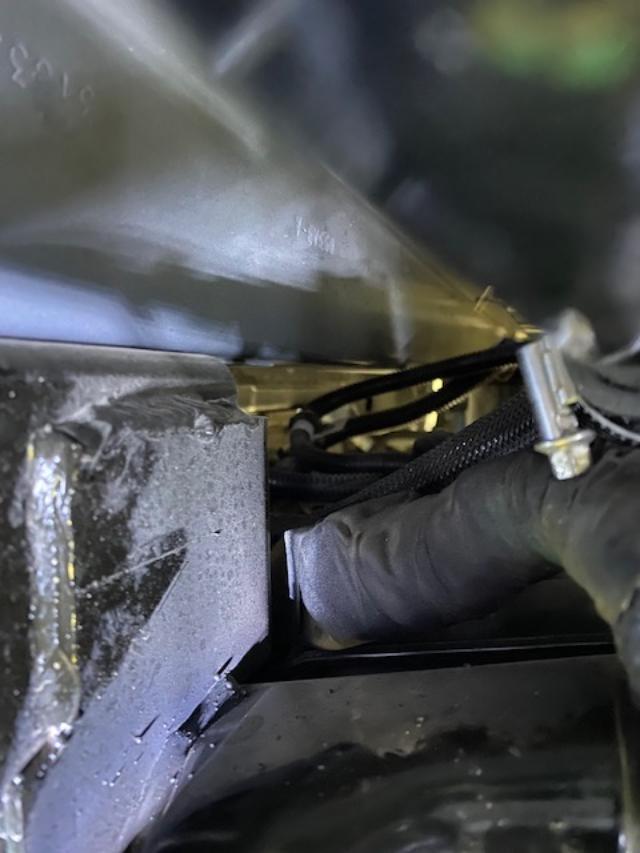

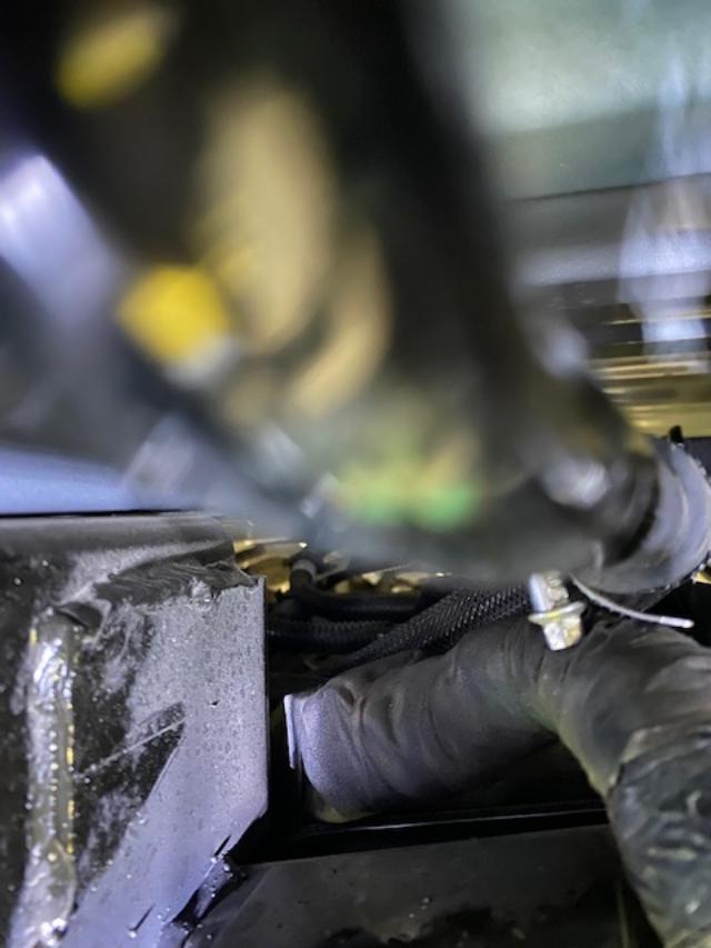

While I was under the new 2020 RAM 3500 dually reconnecting the auxiliary fuel tank to the filler neck, I was looking for the filler neck hose clamp and vent line hose clamp. I found the vent line hose clamp head facing down with the hex part of the clamp head digging into a wire harness that was right there on the frame.
The vent line was resting on the harness and I could feel a indentation in the harness. I don't know if down the road it may have worked itself into the harness causing a short or worse.
Maybe thats the way a engineer wanted it, but it did not look right to me. Of course I turned the head away when reassembling the lines after splicing the aux fuel tank into the filler neck. You should be able to feel it with your fingers.

Good catch. I think a lot of issues can be prevented by a good inspection when new. Always find a lot of stuff that could potentially rub like that on big trucks.
