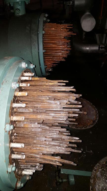

Ice is a bad mama! This is what happened when operations forgot to drain exchangers out at First Energy. Those are (32) B7 grade 3/4" studs that fastened the blinds. Didn't stand a chance.
The red tank appears to be made of a composite material that can expand when the def freezes.
If the def freezes in a metal tank, it will likely bust the tank even if it is not full.
