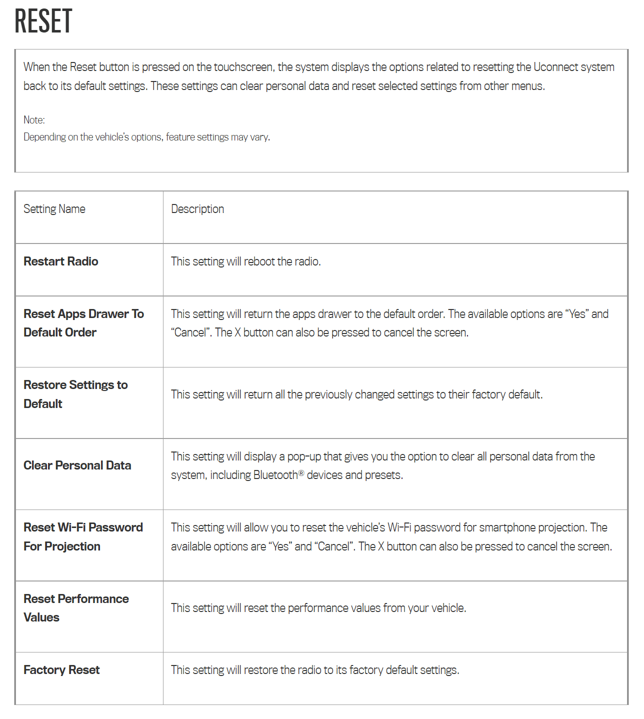

Might as well have them look at the infotainment screen as well. It has done a host of weird things. Mainly If I get in and drive the truck it will work fine. However if I stop and shutdown for a few minutes it will just be blank as in totally blank. I have found that if it is shutdown long enough it will come back on when I restart. I have not timed it yet as I have just been putting up with it. Seems if it shutdown for say 10 minutes or less it doesn't come on. If it is over again say 10 ten minutes it comes back on fine. Also If it is only shutdown a couple minutes or less it comes back on fine.
Then other times it will come on but the sat radio screen is blank but the other functions show and I can switch to say the comfort screen (or the other options) and that/they will come on fine. Switch back to sat radio and blank. If I switch around enough the sat radio screen will come on.
Oh well dealer here I come at some point in the future.
There are a couple different levels of reset for your infotainment screen. I tried the first reset "Reboot" when mine was acting up, it didn't fix it. When I did the "Factory Reset", it fixed my problems.
