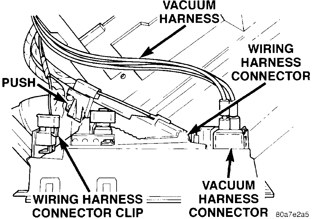

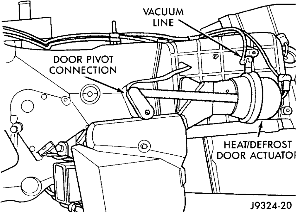

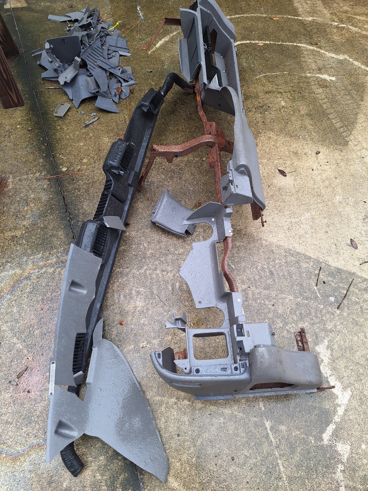

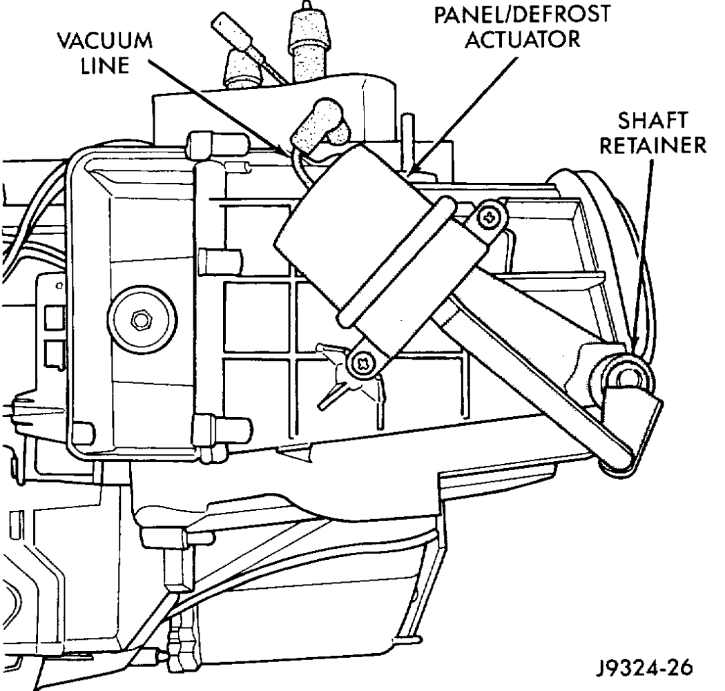

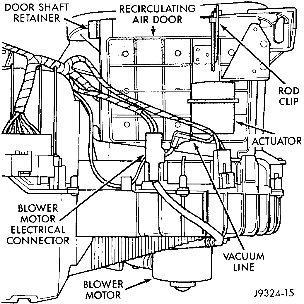

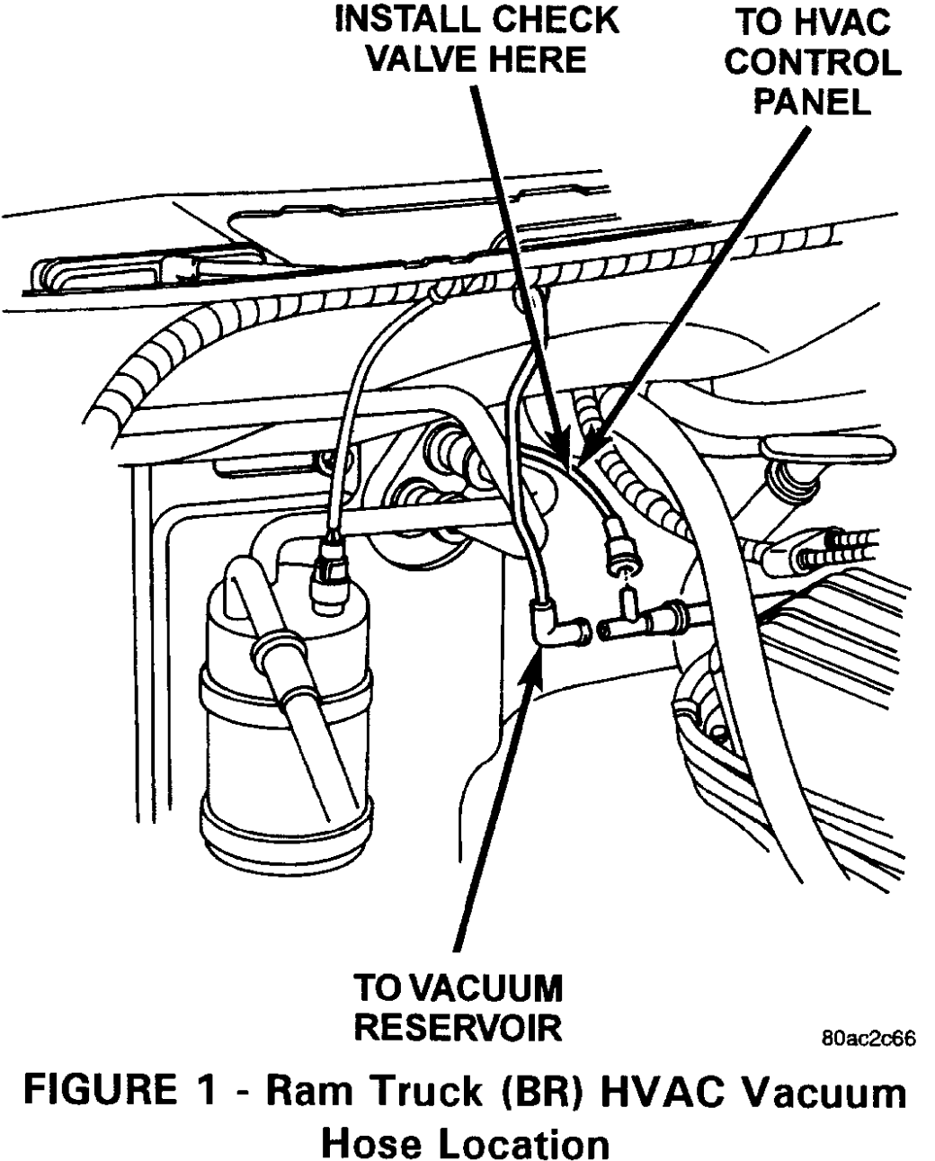

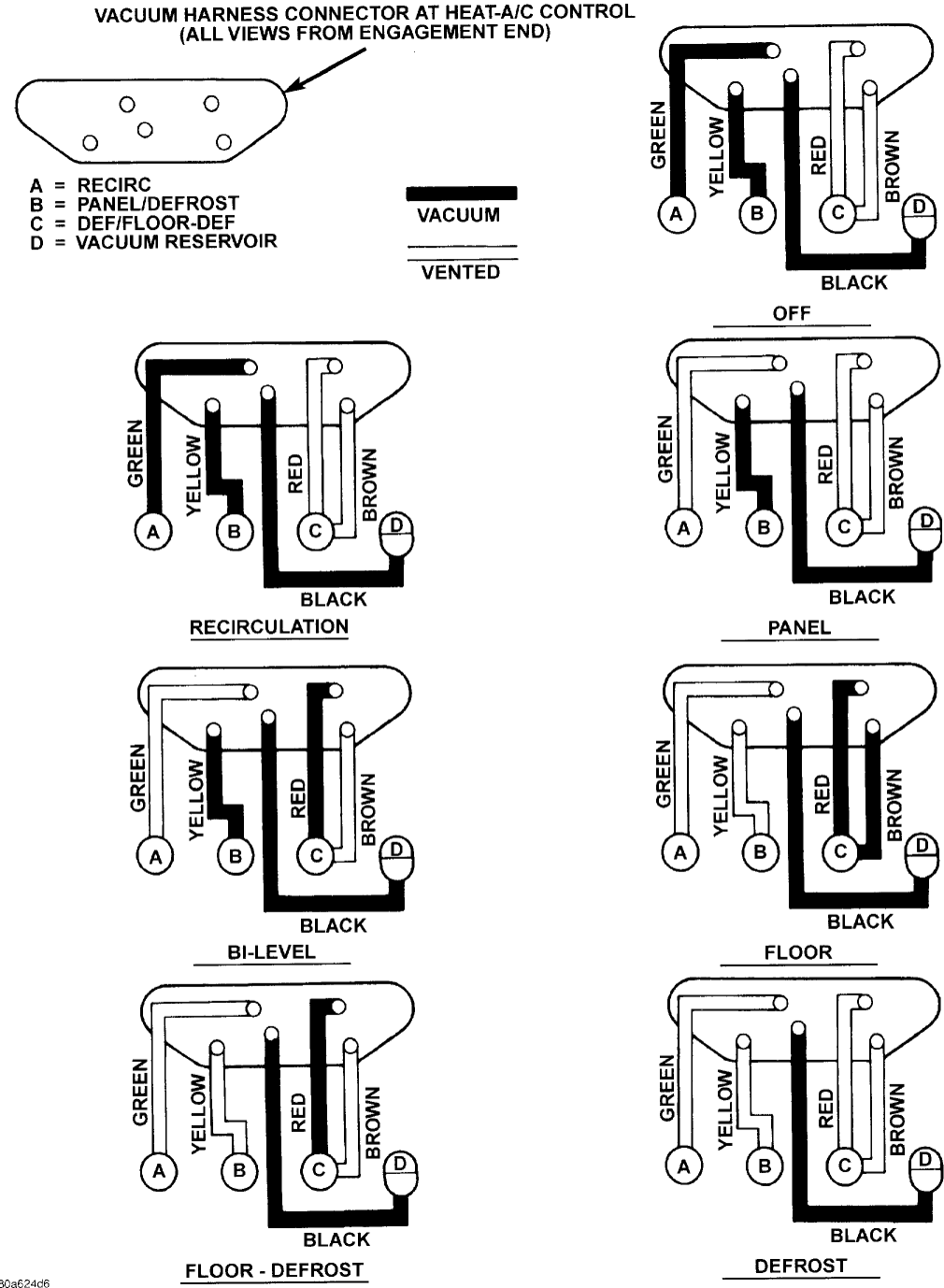

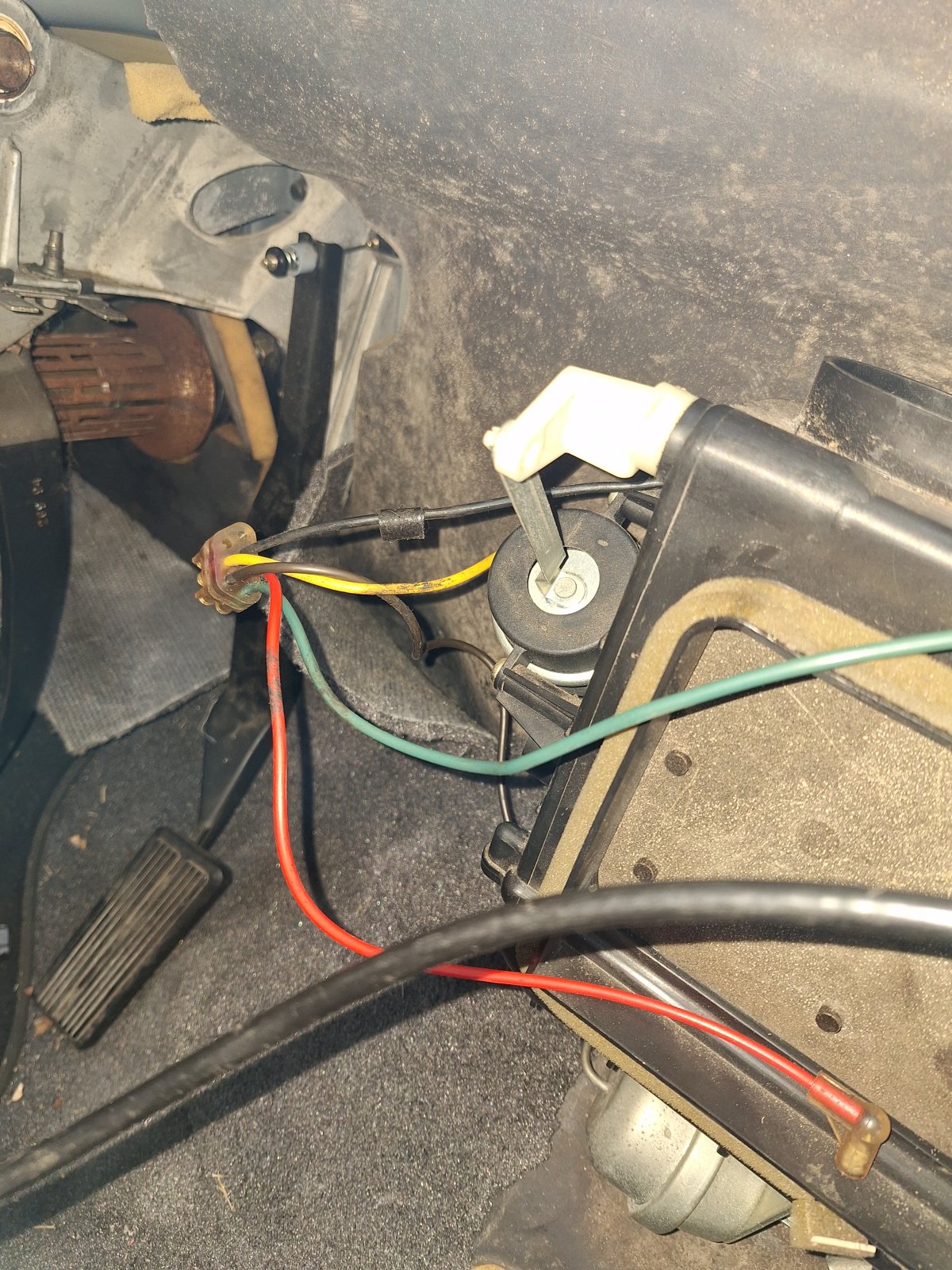

I am reinstalling the heater bow after new AC evaporator and heater core. I did not pay enough attention to the vacuum lines when I disconnected them. I can only find where 3 of the 4 vacuum lines go. Does anyone have a diagram, picture or explain where the 4th line goes. I under stand why no one will take on this job, I added a picture of the dash when I removed it. The top had been replaced about 12 years ago and looked perfect but the center support structure was falling apart. I tried to remove it in one peace to see if I could reconstruct a fiberglass structure but when I lifted the dash to remove it it literally exploded. I have an all aluminum dash from LRB Speed which is a good thing. They where the only replacement dash I could find. I was not going to pay $2,200 for a 340 year old use dash that would be just a brittle. I will post picture if and when I get it installed. vacume hoses.jpg dash.jpg
Thank you very much. That is exactly what i needed. I could not find that any where. I was still not able to find the 2nd connection on the def/floor actuator but i will look again tomorrow.
Thank you again. I got the vacuum line together and I think I got the electrical wiring back together. I have to make some modification to the new dash assemble because the directions call for installing the gauge cluster the installing the new dash and I would need to take the entire dash out again to get to the gauges, and i know I need the speedometer repaired. It is reading about 10 to 15 mph slow.
