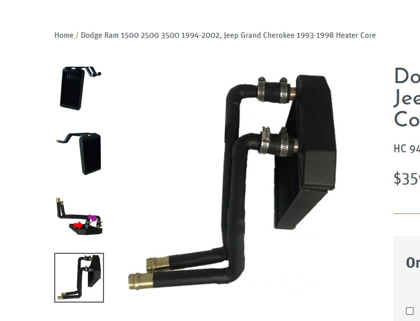

It appears that you have a choice of either, rigid soldered piping, or piping connected with worm type hose clamps. I personally would NOT use the hose clamp type - using them would be inviting a leak to occur.
When I replaced my heater core with the rigid piping OEM heater core, I did not have any real difficulty installing the heater core.
- John

I personally would not use the provided worm-drive hose clamps in an area that cannot be inspected easily. Using them is an invitation for a leak - a leak in a place you cannot service.
Instead, I would use the correct size of a constant tension spring clamp. They are highly reliable and they always apply a uniform pressure regardless of thermal expansion / contraction and vibration.
I rarely ever use a worm-drive hose clamp anymore.
- John
The hose clamps are under the hood. The have to be removed/reinstalled when replacing the rubber heater hoses. I use the spring clamps there, but also have worm drive clamps installed as a backup.
I think this is the heater core being referenced. I don't think these hose clamps are accessible under the hood.
- John
