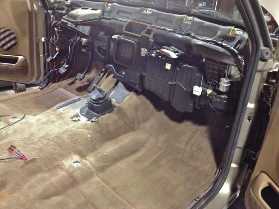

Removed front seats and console. (a really great move. 14 bolts and you have all the work space in the world. )
Six electrical connections on the left side, one vacuum connection in the center and two electrical connections plus antenna on the right side and the dash is disconnected. Five screws across the top, two bolts at the middle bottome and one bolt at the bottom on each side and it swings down and comes out easy.
Spent the rest of the evening un-wiring 10 years worth of electronic gadgets and radios that had effectively stitched the dashboard to the cab.
Removed dash (actually easy when all the other wires are not there)

HVAC out of truck and on bench.

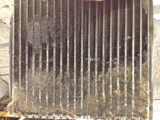

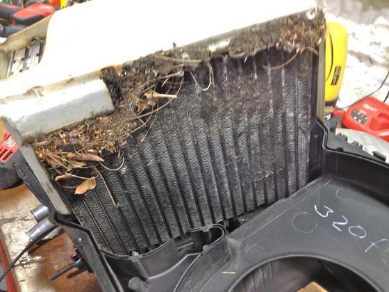

Opened HVAC. Wow, am I glad i decided to go the long way. Dirty, filthy, stinky. I was breathing air that was pumped through this???
This is really plugged.
A/C evap was 50% blocked and had 2 inches of mulch stacked against it from all the decayed leaves and such. (screen installed in intake to stop this now)
Disassembled entire HVAC, cleaned, verified all doors good and functional.

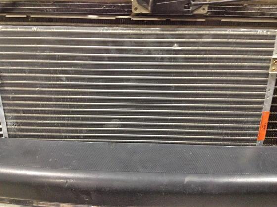

Installed new A/C condenser on front of truck. (Big difference from that moth eaten looking thing that was hanging there)
