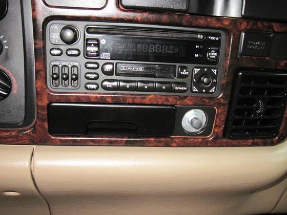

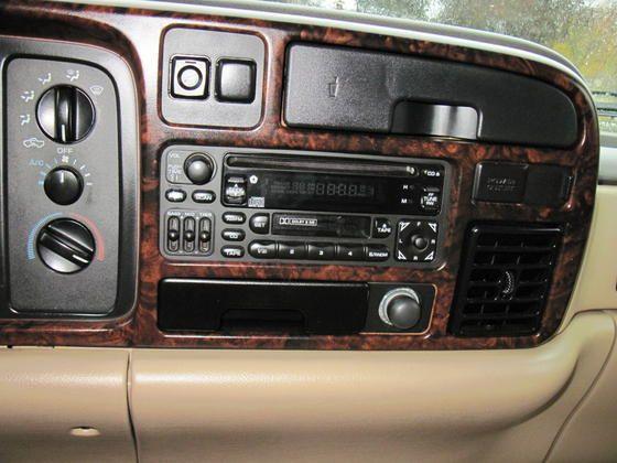

Instead of a toggle switch, how about a momentary switch. I used a universal push button starter switch, easily available from an auto parts store or farm and tractor supply store. I mounted mine where the cigarette lighter used to be. I don't smoke, but I still have the power outlet available for gps, cell phone charger, etc. I wired the positve directly to the relays and ran the ground wires to the switch.

That's right. I replaced both relays and wired them so that they both come on at the same time. I ran the positive directly to the relays from the battery. I don't know much about electricity, but I figured it would be safer to just run the ground wires to the push switch. I had my truck for a bout 3 years and had the same problem you did. I started by removing the air intake, and checked each grid individually by running booster cables to them. They both got red hot in a short period of time. Once I knew the heaters worked, I replaced the relays and ran the switch to my dash. I check the function ocassionally by pushing the switch after the truck starts and watching the ammeter drop. You just have to be a bit careful when working under the hood. I get clumsy, sometimes and short out the relays with a ratchet or screw driver. Nothing serious. If you get creative, you could make a cover for the relays or just get in the habit of disconnecting battery cables, or just being careful. If I could figure out picture attachments and try to send a few, but it's really simple and straight foreward. Sorry I didn'y get back to you sooner, I had guests and they just left.

I started playing with the attachment feature. Not sure if they will display. I guess by know you figured, I'm not too good with computers. One is with the rubber cover threaded on and the other without. I didn't have to do any cutting or drilling. Just had to find a common washer for the switch.
