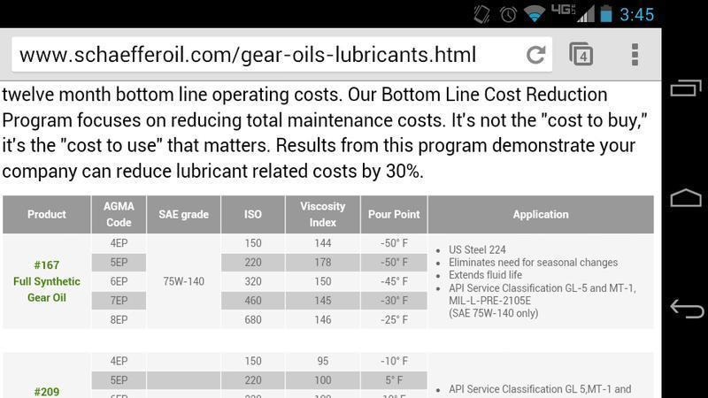

Some info on the oil also my manual says to use 75 140 when pulling heavy
The Dana axles like a heavier fluid for heavier towing, but is highly doubt that going from a 90 to a 140 is giving you a noticeable reduction in fuel economy. The fluid would have to be like molasses.
