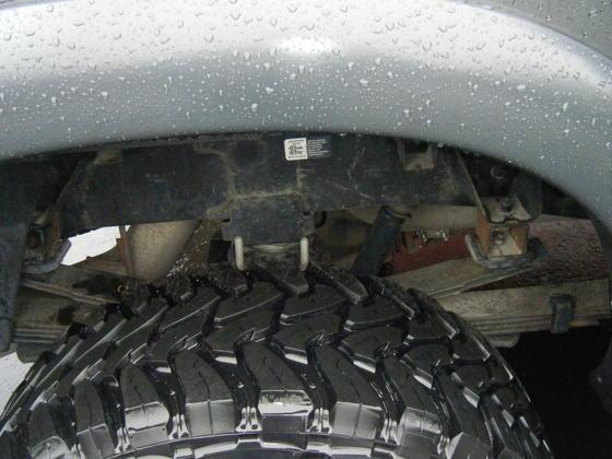

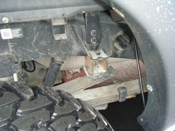

On my 3500 dually I installed a 2" x 2" tube 3" long between the bumper (rubber) and the frame. I installed the tube at each end of the overload spring and the effect was to get the over load spring engaged 2" sooner. This adds to the over all weight that the truck will haul as it now deflects the over loads farther... I don't know if this alone will solve your problem but it sure helped me when I had the truck overloaded.
This is a good idea, and exactly what I did.

Yes I have overloads as in the pic by jjpage above.

All 3rd gen 3500's have overloads, I would just shim them if you don't want to use airbags.
