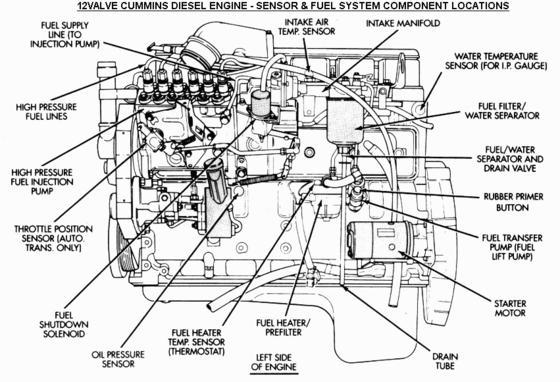

visualize an imaginary vertical line just forward of the fuel filter and a horizontal line below the fuel s/o solenoid. The oil sighting is in this imaginary quadrant with the bulk of the oil collecting on the drivers side motor mount.

I found it, it took me a few minutes... ...
Maybe this will help.
Mike.
Yep, I have the factory manual with this pic as well. too me it seems as if the engine vent tube is the logical culprit. . I have yet to physically check it though. Nothing else in that quadrant that would be an "oil" leaker that I can see which is why I am reaching out to the experienced ones;-)
