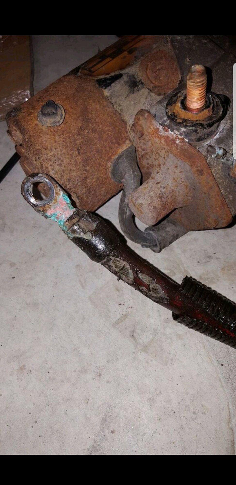

My 1998 12v battery cable clamps were in terrible shape, so I decided to replace them with the military style battery clamps from Larryb"s. I am stuck right now because I can't figure out the size of the HUGH positive battery-to-starter cable so that I can get the correct size crimp on lug for it. I have both 1 AWG and 2 AWG lugs, and both are way too small for this cable. Does anyone know what size this cable is, or what size lug I need to get for it?
Many thanks for any/all help
1/0 best as I can recall, I changed mine to 2/0 years ago and can’t remember what the stock size was for sure..
Little scotchbrite and bailing wire will be good as new!
