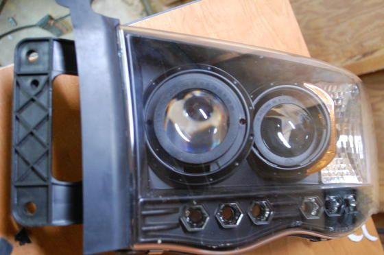

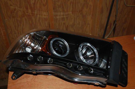

The stock reflectors are not designed for the HID bulbs, as stated in the past the light scatter is incredible and BLINDS oncoming traffic. Personally I do not want to be the cause of someone wrecking. I am modifying a set of lights with Hella projector units. I am placing Hi and Low unit in each of the housings and they are HIDs but throw a nice beam on Low and really nice beam on High. I am still working on the mods and will post once I get them installed.
</SPAN>
BEFORE:
AFTER:
